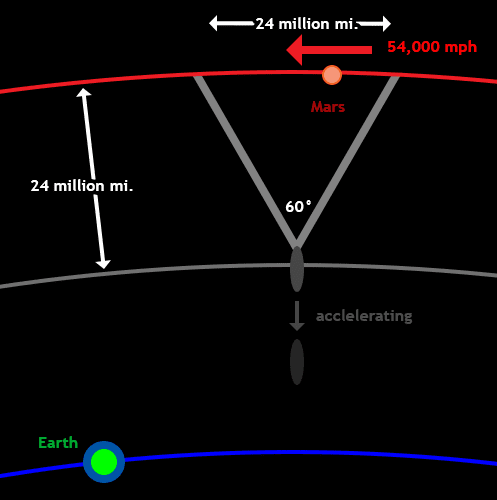

I'm writing a science-fiction novel. The setting is space...shocker, I know. I'm playing with a portion of the plot that involves (hopefully) a spaceship "sitting" in space. Specifically, a spaceship sitting between Earth and Mars. I want to place the ship in space so that it's not orbiting either planet.
I realize that the planets revolve around the sun, that the sun is moving within the Milky Way, and that the Milky Way has its own vector through space, etc.
But, relatively speaking, would it be possible for a spaceship to "sit" in space between the orbits of two planets?
Part Two
If the answer to Part One, above, is "Yes, it's possible," then assume the spaceship is pointed away from Earth toward where Mars would be. Further assume that a human is looking out a window of the spaceship (I know...windows in space...humor me). Finally assume the position, angle, etc. is such that the planet Mars, following its orbit around the sun, will at some point come into the field of vision.
How long will it take for Mars to pass through the field of vision? I'm not looking for an exact number, but would it be hours, days, longer?

How long does it need to sit? You can work out its slow fall toward the sun. For a short enough time, it could be considered stationary to the naked eye.
(Edit: after examining the second half of the question, I assume about 18 days?)

If the passenger stuck her nose against a curved porthole, she could see quite a bit of star field to left and right.Earth orbit and Mars orbit are very roughly 48 million miles apart. If your spaceship is halfway between them, that's 24 million miles from Mars. If you assume a 60 degree field of view out a porthole, that's an equilateral triangle, so you'll get a field of view of 24 million miles at Mars' distance.
Mars travels at about 54,000 mph along its path (which can be considered straight here). Moving at 54,000 mph, Mars will take - again, very roughly - 18 days to cross 24 million miles.
At 24 million miles, Mars -being 2100 miles in diameter, but subtend .5 minutes of arc. That would be large enough to look disc-like against a background of points. And it would be bright. And full.
To summarize, without hard numbers:
To the naked eye a passenger might see a very bright dot making its way across the star field by a few degrees every day - say, a couple of finger's widths. Over that time it would shrink and dim somewhat as the spaceship fell toward the Sun.Finally: does her craft have even the slightest rotation relative to the background stars? It would take deliberate effort to ensure it has zero rotation over a period of 18 days. Unless it is perfectly fixed, she won't be able to use the porthole to measure movement. She'd have to check it relative to nearby stars to see motion.
And this would be complicated by the fact that her ship is falling away from it. Due to parallax, Mars would initially appear very slow or stationary wrt nearby stars but then appear to accelerate as the days pass.
BTW, if you're going to write science fiction, you should try to have at least this level of estimation.
I was able to do it and all I did was draw a mental map, Google some numbers and come up with an estimate.

Unless she's immobile, she can get as close to the porthole as she wishes, while looking left or right. Ideally, her field of view out a flat porthole approaches 180 degrees. At 24 million miles from Mars' orbit, by pressing her cheek against the porthole, she could keep it in sight through about 68 degrees of Mars' orbit, or about 118 days.

If it's literally stopped in space relative to the sun, yes.
But that depends on your story. Any reason it couldn't have a boost once in a while? Or even a initial outward velocity before going dead, so that the fall is partially canceled over the observation period?

Without thrust, yes. However, this is not necessarily a total game ender. At a point halfway between Earth's and Mars' orbits, the acceleration due to the pull of the sun is only ~0.0037 m/s . Over the 18 day period mentioned above, this equates to the equivalent of a delta v of 5.8 km/sec. This is doable even with chemical rockets. (Though a great deal of your ship would have to be fuel; a 4 to 1 fuel to ship ratio just to hold position, not counting fuel needed to get there and back)
If, however, you assume you are using something like an Ion engine capable of producing the required thrust, with an exhaust velocity comparable to that of the Ion engines used for the Dawn mission, you would only need to use ~0.02 kg of reaction mass per kg of ship to maintain station keeping for that long.
