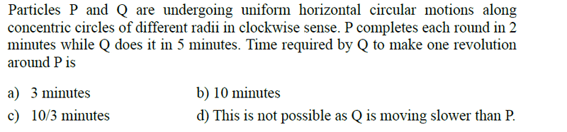

Two particles undergoing circular motion
The discussion revolves around two particles undergoing circular motion and the calculation of their relative angular velocity. The original poster expresses difficulty in determining the angular velocity of one particle with respect to the other due to the changing relative velocity as both particles move.
  • Participants suggest using relative angular velocity and question how to calculate it without additional information. Some discuss the definitions of relative angular velocity and whether they are equivalent, while others explore the implications of different reference frames.
There is an ongoing exploration of the definitions of angular velocity and relative motion. Some participants have offered guidance on calculating angular velocities and suggested drawing diagrams to visualize the problem. Multiple interpretations of the problem are being discussed, particularly regarding the roles of the two particles in their respective circular paths.
Participants note that the problem lacks specific information about the radii of the circular paths, which complicates the ability to reach a definitive conclusion. There is also mention of potential misinterpretations of the data provided.

I am actually stumped by this seemingly simple problem . Since both the particles are moving , in order to calculate angular velocity of Q with respect to P looks to be difficult as the relative velocity of Q w.r.t P is changing at all times .
Am I missing something simple ?
Please help me with this problem .
Thanks .

I think you should use the relative angular velocity between the two particles. Also, particle Q should move along the outer circle. Is the answer provided?

Could you explain how to calculate without being given any other information ?
Presently I do not have the answer .

You can calculate the angular velocities of both the particles using given information (in rad/s). The difference between them will be the relative angular velocity. Using this velocity, you can compute the time required by Q for one revolution around P, provided that Q is in the outer circle.

Oh ! I was misreading the data . Strangely I was reading minutes as m/s o:) .

Is relative angular velocity simply the difference between the angular velocities of two particles ?
I thought it was tangential component ( perpendicular to the line joining the two ) of relative velocity divided by the distance between the two points .
Or are the two equivalent ?

Yes.

You should draw a diagram of the motion of the two particles. Perhaps plot their approximate position every 30s or 1min and see how one moves with respect to the other.
PS I would change Q's rotation to 4mins for the diagram to make things simpler.

I understand how relative angular velocity is difference between the angular velocity of the two particles . The problem is solved .
Could you explain mathematically how the two definitions of angular velocity in post#7 are equivalent ?

You have to imagine P "looking" in the same direction all the time. Alternatively, choose P's reference frame, in which Q rotates anti-clockwise (but not in a circle). Or, Q's reference frame in which P moves clockwise. This is better, actually, than drawing both points moving. And probably the simplest way to look at it.
I don't really understand your second definition of relative angular velocity.

They are different.
The first definition supposes the two angular velocities are each defined in terms of some other point as a common centre of rotation. The second takes each as reference for the other.
I can see your difficulty. Let us suppose Q is outer, but instead of P moving in steady circles it just moves randomly about inside Q's circle. It takes Q 5 minutes to go around P. How is this changed by P moving in steady circles also? It isn't. The answer is still 5 minutes.
If P is outer, Q does not go around P at all, and that is nothing to do with Q's being slower.
In my view, the question setter has outsmarted himself.
To rescue the question, you have to think of P and Q as observers who always face ahead in their motion, and ask how many times Q appears to P to have gone around. I.e. use P as a rotating frame of reference. Does the answer to that depend on which is outer?

To me, the problem as posed is not solvable. Let us define the rate of "revolves around" by imagining a telescoping, straight, massless rod connecting the two particles end to end and asking how many times this rod rotates 360 degrees end over end per unit time on average. The system will return to its starting state in ten minutes. So it suffices to find the number of rotations made by this rod over a ten minute span and divide by ten minutes.
Suppose that the radius of Q's circle is larger then P's. Then in 10 minutes, the rod will have made two complete rotations due to Q's motion while P's gyrations are irrelevant.
Suppose, contrariwise, that the radius of P's circle is larger. Then in 10 minutes, the rod will have made five complete rotations due to P's motion while Q's gyrations are irrelevant.
Since we are not told which radius is larger, the problem has no unambiguous answer.

I think irrespective of which one of P and Q is in outer radii , from P's frame Q appears to be rotating with angular speed 0.3 rev/min anticlockwise . Is that right ?

Yes, but that is not what the question asks. It asks for the time "for Q to make one revolution about P".

Wouldn't that be 10/3 min ?

If Q is on the outer path, yes, but what if it is on the inner circle?

In that case Q doesn't revolve around P .

Right. Using P's rotating frame of reference, Q will still appear to complete a circuit in 200 seconds, but it does not go around P.

Yes, the relative rate around the common centre is .3 rpm.
If Q is outer, in P's rotating reference frame, P sees Q as going around P, backwards, maintaining a constant rate in a circle about some point (but not a constant angular rate about P). Regardless, P sees Q as having completed one lap of P in 10/3 minutes.
If P is outer, in P's rotating reference frame, P sees Q as maintaining a constant rate in a circle about some point, but P is outside that circle, so Q never completes a lap of P.

How would Q appear to move as seen from P i.e trajectory of P w.r.t Q ? I think it is not a circle . Right ?

Right. Epicycloid?

One last thing , refer to @jbriggs444 post #14 , if P moves in outer radius and if we connect P and Q by an imaginary line , don't you think , that line completes one full rotation as P and Q move. Doesn't that count as one revolution of Q around P ( despite Q moving in smaller radius ) ??
With P in the outer circle, in P's rotating reference frame, that line would wiggle about a bit, but return to its original position without completing a revolution.
In the lab frame, the line would complete a revolution, but you would describe it as P going around Q, I think.
