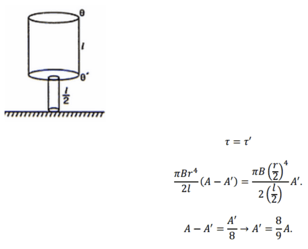

Two rods joined together, find the angle of twist

Honestly , I have no idea about this problem . No theory whatsoever has been given in the book . Please help me in understanding this problem and the relevant concepts involved to solve it .

I am attaching the solution to this problem . Please explain this . What is ζ ? What is B ? How did they write the second step ?

I do not see any ζ. τ Is the torque. This will be the same in each rod, so τ=τ'.
A is the total angle of twist (i.e. θ in the question as stated). A' is the portion of that which is in the smaller rod, so the larger rod twists through A-A'.
B is some modulus, a property of the material. Since the rods are of the same material this will cancel.
The polar moment of inertia describes how well the cross-sectional geometry of the object resists twisting. For a cylinder this is ##\frac{\pi r^4}2##. But the longer the rod, the more the twists of small disc elements add up, leading to ##\tau=\frac{B\pi r^4}{2l}\theta##.
Applying that to each rod and equating the torques gives their equation.

By action and reaction. The torque the first rod exerts on the second must be equal and opposite to the torque the second exerts on the first.

But , isn't torque , due to the force applied at the free end of the large rod . Why would this torque be same throughout the two rods ?

For the reason I gave, action and reaction at the interface.
Or we can consider the rods made up of thin slices. Each slice of each rod transmits the torque to the next slice. If this were not so there would be a net torque on a slice, leading to angular acceleration.
It's like tension and compression in linear forces.

I still do not understand why the difference of angle of twist at the ends of the rod appears in the expression for torque on the rod .

The torque, τ, puts a twist into each rod. The two twists are in the same direction, so they add up. We are given what they add up to: A in the solution, but called θ in the original question. So if one twists through angle A' then the other twists through A-A'.

I might be wrong , but I think twists at the two ends of a rod in opposite direction should add up .
Suppose there is a twist A at the end in a rod and there is also a twist A in the same direction at the other end . Wouldn't the net twist be zero ?

I mean looking always from the same end. If you are looking from the end of rod 1 and it twists clockwise by θ up to the point where it meets rod 2, then rod 2 twists clockwise by φ from there up to its far end, then the total clockwise twist is θ+φ.

The twist given in the question is the net total twist given to the system of the two rods ?

Yes.
