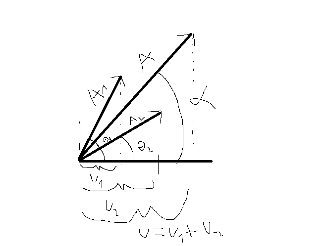

Two wave superposition with different wavelength , amplitude and frequency
u1(x,t)=A1cos(k1x+w1t)
u2(x,t)=A2cos(k2x+w2t)
a)Show that an amplitude modulation is obtained
No relevant equations
u=u1+u2=A1cos(k1x+w1t)+A2cos(k2x+w2t)
and now i don't know what to do, is there any way to relate A1 and A2
I searched in the internet and I found Fresnell method which can solve it for two waves of the tipe:
u1=u2=A1cos(w1t)
u2=A1cos(w2t)=A1cos(w1t+phi)
but in my case I don't think I can do that because there are 2 variables in the cos

Try this: Draw a right triangle with the length of one leg equal to ##A_1##, the length of the other leg equal to ##A_2##, and with hypotenuse equal to ##\sqrt{A_1^2+A_2^2}##. Then express ##A_1## and ##A_2## in terms of ##A## and an angle ##\theta##, appropriately defined. That might get it into a form you can more easily work with.
I'm just making a suggestion. I haven't actually worked the problem out, so the suggestion may not turn out to be useful.

Maybe I can prove that there's a Amplitude modulation without merging the cos
Hand-drawn phasor diagram with vectors A1 and A2 from a common origin at angles θ1 and θ2 to a horizontal axis, their sum A shown as the resultant, with projections labeled v1 and v2 and the equation v = v1 + v2 below.
I think i found a way to solve it so if i make two vectors where A1 and A2 is the module of each vector I just have to sum them and then find the angle of the resulting vector.
Where θ1=k1x-w1t
θ2=k2x-w2t
u1=A1cosθ1
u2=A2cosθ2
And alfa=(θ1-θ2)/2+θ2=θ1+θ2/2
