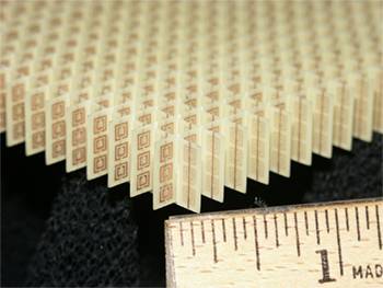

I want to control a magnetic field with metamaterial design by PCB. That's why I need that order of wavelength. What magnetic field strength can I expect?
Sorry, what does that mean? What metamaterial? And is PCB = Printed Circuit Board in this context?
berkeman said:
What metamaterial?
Like these?
https://en.wikipedia.org/wiki/Metamaterial

Like was said earlier, you don’t sound like you want an electromagnet itself, but something more like a magnetron(which uses an electromagnetic as one part) so you can produce electromagnetic waves.
You haven’t really explained what you’re trying to do. Are you trying to measure the absorption properties of this “meta-material”, testing it like radar asorbing material would be tested?
Most of these kinds of tests would be done in an anechoic chamber. I don’t know if your university has one or not. Are you working with an advisor on this project? Have you asked them for some help/guidance?

What I want to do is putting an electric AC current in the electromagnet so it can generate an AC magnetic field. I don't want to create an electromagnetic waves.

The magnetic field will induce an electric current in an array of split ring resonator. Which will generate a magnetic field that interact with the first one.
A Split ring resonator is a type of structure in such metamaterials and will produce rotating currents which can enhance or interfere with the incident field.
