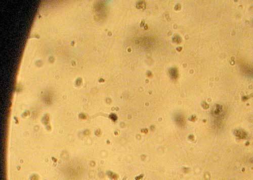

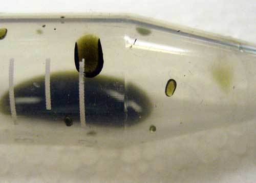

OK, so I took it to a lab. Here're the results.
Acetic acid: none to marginal solubility - merely muddies the solution
Conc. hydrochloric acid - very soluble - turns solution bilious yellow-green
Sodium hydrochloride - not soluble at all
Definitely magnetic.
Not radioactive.
I had better pix using the microscope CCD but they didn't take.
Pic 1 - 10x mag smeared out on a piece of paper
Pic 2 - 1000x mag fixed on slide
Pic 3 - solution of HCL
Sounds like an iron (II or III) oxide or hydroxide with finely divided iron/steel particles and possibly a little copper oxide. Pic #3 indicates that the powder is not completely soluble in HCl? Kind of greenish yellow. I would dilute the solution with about 2 - 3 tsp of distilled water (not tap water) and test with iron and copper water quality strips. Accurate to 0.02 to 5 ppm for iron and 0.5 to 10 ppm for copper.
http://www.omega.com/pptst/WTS_Series.html
What is 'sodium hydrochloride'? Sodium hypochlorite? Sodium chloride? Sodium hydroxide? Probably sodium hydroxide...
Try to isolate the HCl solution by dilution with a couple of tsp of water and settling out and removing the insolubles. A bit of coffee filter jammed loosely (but not too loose) into a pipette or an eyedropper is a good small scale plug filter for this task. Use the bulb of the eyedropper to help push the solution through the plug filter. The solution should be faintly yellow green. Add some clear ammonia solution (not sudsy) dropwise until the pH is >10. Solids should form and form a floc. Try to get this to settle or filter using the plug filter. This will be the brown iron hydroxide (if present). The copper should remain in solution which will be deep blue.
