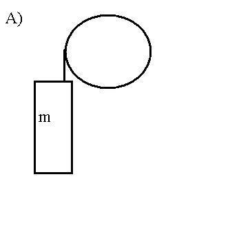

In each question: you place mass m on the mass holder, and released the system from rest. The system includes two pulleys and a long rod with two point masses on it.
a) In procedure 1: if you increase m, the mass on the mass holder, what happens to the following quantities:
- α, the angular accelertion of the pulley.
- I, the moment of inertia of the pulleys-plus-rod system.
In procedure 2: if you move the two masses attached to the rotating rod away from the center of mass of the rod, what happens to the following quantities:
2. The attempt at a solution
For part (a), I thought the answer is α increases, I increases, but it's wrong.
For part (b), I thought the answer is α decreases, I decreases, but it's also wrong.
A lot depends on the arrangement of the pulleys - do you have a diagram?
You should also show your reasoning ... in each case the answer could be "increases", "decreases" or "stays the same" ... so why would you expect the quantity to "increase"? Under what circumstances would each quantity remain the same or decrease?

The first image I uploaded is the diagram for the first part.

For both parts of the question, why aren't my answers correct?
Sorry for another post.
I am not sure why the first and second answers are incorrect.
1. α should increase if you add more mass, but I would thought that inertia increases too.
My second chance is that α increases while inertia stays the same.
2. α should decrease if both masses are added to both sides. Then, inertia stays the same as always?
Focussing on part 1 for now:
In your attached diagram, part 1 only has one pulley. Is not part of a system involving more pulleys?
I notice there is no rod in the diagram you supplied - but there is one in the question. What happened to it?
from the free body diagrams:
for the pulley: ##rT=I\alpha=\frac{1}{2}MR^2\alpha## (taking anticlockwise as positive)
for the mass: ##mg-T=ma## (taking down as positive, so that ##a=R\alpha##)
r= radius of where the string pulls
R=radius of the pulley - in your diagram r=R.
M=mass of pulley
m=mass of weight
eliminate T from both equations and solve for ##\alpha##.
How does ##\alpha## depend on the mass?

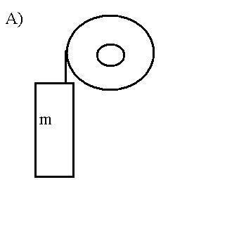

I can't demonstrate the diagram for the second part. Sorry about this.
That is just a pulley for the first part only. For the second part, there are two masses on the pulleys...
Oh! I mean for the diagram I just posted, I treat the circle as the rod.
You mean the rod is an axle?
Doesn't it have two point masses on it?
Anyway - I added a bit to post #6 while you were replying.
Do the questions in reverse:
In Part 1.
You added the mass to the falling weight - what does that do to the
(a) moment of inertia of the pulley (you said in increased - why? what is your reasoning?)
(b) angular acceleration (you said it increased - what is your reasoning?)
... the previous discussion of a free-body diagram should help here.
In Part 2.
The falling weight stays the same - but the small masses are extended farther from the axle.
(a) moment of inertia of the pulley (you said it decreased - why? what is your reasoning?)
(b) angular acceleration (you said it decreased - what is your reasoning?)
Looking at them in that order should help.
Telling me your reasoning will help me explain it to you if you still don't see it ;)
