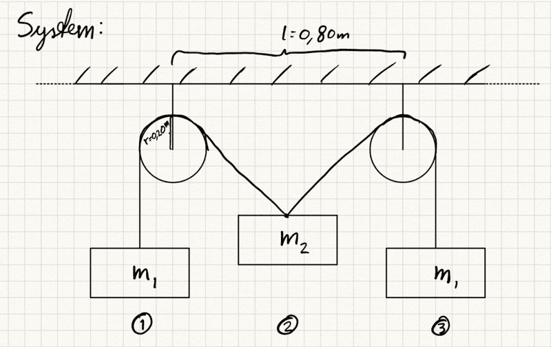

I used m1=m2=15,0kg
System:
Hand-drawn diagram of a pulley system: two pulleys hang from a horizontal bar with the label l = 0,80 m spanning them. A rope runs from each pulley to a central mass m2 and down over each pulley to hanging masses labelled m1 on each side, marked as positions 1, 2 and 3. The left pulley is labelled r = 0,20 m.

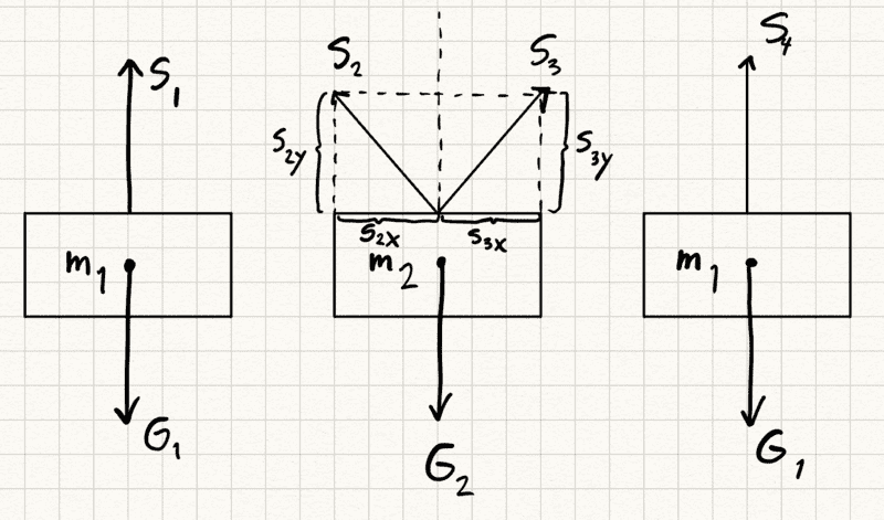

FBD:
Free-body diagram of three masses: m1 on the left with tension S1 up and weight G1 down, m2 in the middle with tensions S2 and S3 meeting at a point with components S2x, S3x, S2y, S3y and weight G2 down, and m1 on the right with tension S4 up and weight G1 down.
Note: I believe I have solved a) correctly and am more confused about b).
a) I started with drawing the FBD. Knowing that the net sum has to be zero for the system to be at rest I used the left mass to find the tension on the rope: S1 = G1 = 15kg*9,81m/s2 = 147,15 N. Now that I know the tension I moved over to the middle mass. I know G2 = 147,15 N and that |S1|=|S2|=|S3|=|S4|. As the system is symmetric on each side I didn't do anything with the x-component of S2 and S3 on the middle mass, as they cancel out.
I know that S2y + S3y = G2 or rather 2 * S2y = G2 to simplify as the system is symmetric. Therefore S2y = G2/2 = 147,15N / 2 = 73,575 N.
It looks like the system can be at rest, I just have to find the angle on the ropes on the middle mass.
I know that sin(θ) = S2y / S2.
θ = arcsin(S2y / S2) = arcsin(73,575N / 147,15N) = 30 degrees.

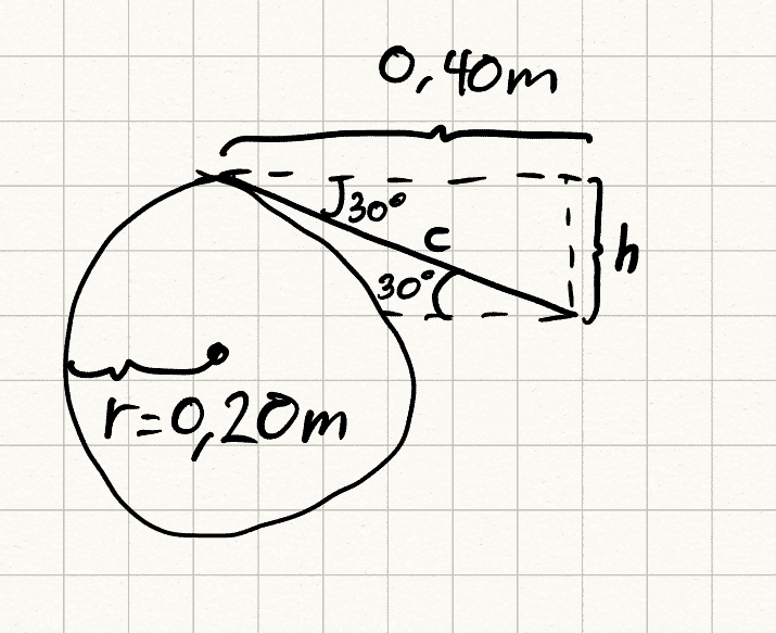

So the system is at rest when the angle between the mass and each rope is 30 degrees.b) I used the radius of pulley r=0,20m, the rope length s=3,0m and the length between pulleys (centre to centre) l=0,80m. Again, the system is symmetric so I will look at the left side. I will also use the connection points between the rope and the masses as their position. A simple diagram:
Hand-drawn geometry sketch of a circle of radius r = 0.20 m with a tangent line from its top to a point to the right, forming a right triangle with horizontal leg 0.40 m, vertical leg h, and an angle of 30 degrees marked at the tangent point and at the lower corner; hypotenuse labelled c.
I can find the length h from a straight line between the pulley tops to the middle mass by doing the following:
tan(30deg) = h / 0,40m
h = 0,40m * tan(30deg) = 0,23. I can then find the rope length to the top of the pulley from the middle mass by:
sin(30deg) = h / c
c =h / sin(30deg) = 0,40m * tan(30deg) / sin(30deg) = 0,462m
Also, the rope length around the pulley is about a quarter circle: 0,40m*π / 4 = π / 10 = 0,314m.
The length from the leftmost point of the pulley and down to the left mass is 1,5m - 0,462m -0,314m = 0,724m ≈ 0,72m.
If we now make the coordinate system have its x-axis along the top of the pulleys, and the y-axis through the centre of the first pulley, the masses would have the following positions:
Left mass: (-0,20, -0,20-0,72) = (-0,20, -0,92)
Middle mass: (0,40, -0,23)
Right mass: (1,0, -0,92)
Is this correct? I feel like I'm missing a function to figure out how much rope goes around the pulley as I believe this will be more than a quarter circle if the middle mass weighs a lot more than the outer masses. But I'm not sure how to get started here.
As for c, I want to make sure I got b correct first, and I think it'll solve itself without being too difficult as the angle the system is at rest is only dependent on the masses and can also be found with arcsin(m2 / 2m1). Then I would just follow the process in b).

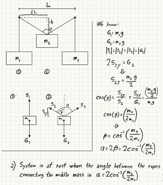

Thank you for answering!
So I redid a) using symbols, I'm not sure why I didn't do that in the first place so thanks for reminding me:
Diagram of two pulleys with masses: m1 hangs from each side and m2 hangs from a rope between them, with angle alpha at the middle rope. Below, free-body diagrams for m1 (S1, G1) and m2 (S2, S3, S2y, G2). Right side lists equations for cos(beta) and alpha = 2cos^-1(m2/2m1).
This matches my previous answer, but I can now change the masses without doing it over again.
For part b) I added a length of the rope R, made the Y-axis go through the centre of the left pulley, and the X-axis go through the centre of both pulleys. Now the length of the rope in total on the left half of the system is $$\frac{1}{2}R$$ and I can use the imaginary triangle drawn in the system overview in the figure above to find the length of the hypotenuse c:
$$\sin{\beta} = \frac{\frac{1}{2}L}{c}$$
$$c = \frac{L}{2\sin{\beta}}$$
The length of the rope from the left pulley (in other words the left pulley's Y-coordinate) is then given by:
$$\frac{1}{2}R - c$$ which can be written as $$\frac{1}{2}R - \frac{L}{2\sin{\beta}}$$ We find the angle beta or 1/2 alfa from a), so we don't have any unknowns variables here. R and L is of course chosen by us.
Now to find the height of m2 I can use that $$\tan(\beta) = \frac{\frac{1}{2}L}{h}$$
$$h = \frac{L}{2\tan{\beta}}$$
And we know h will be the negative y-coordinate for m2.
I think I got this down with a negligible radius at least, but I have to look some more into solving it with a larger radius for the pulleys, thanks a lot for the help so far!
As for erobz' answer, I realize the rope will be perpendicular to the line from P to O which gives me yet another right-angle triangle to work with. I have to think some more about this one.

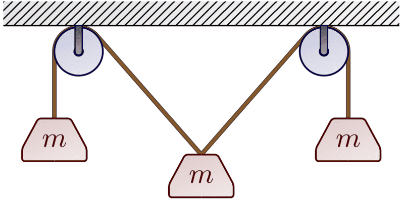

The problem is not in English, but translated it reads:
The figure shows two pulleys and three masses. You choose the value for the mass m, the starting position for the masses and the distance between the pulleys. Disregard the friction in the pulleys and the air resistance. Is it possible to make all the masses stay in place (system in equilibrium)? If so, what is the position of each mass? What happens if you change the weight of the middle mass? Draw a FBD for every mass and use Newton's laws to analyze the problem.
Diagram of two ceiling-mounted pulleys with three masses, each labelled m, connected by a string: one mass hangs from each outer pulley and the middle mass hangs from the string strung between them.
That is absolutely everything that's given.

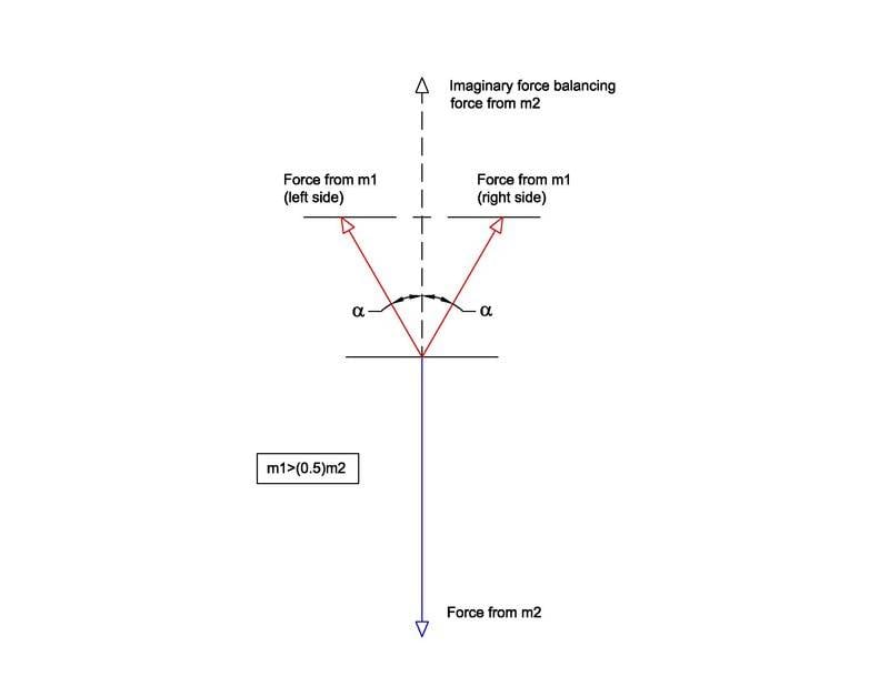

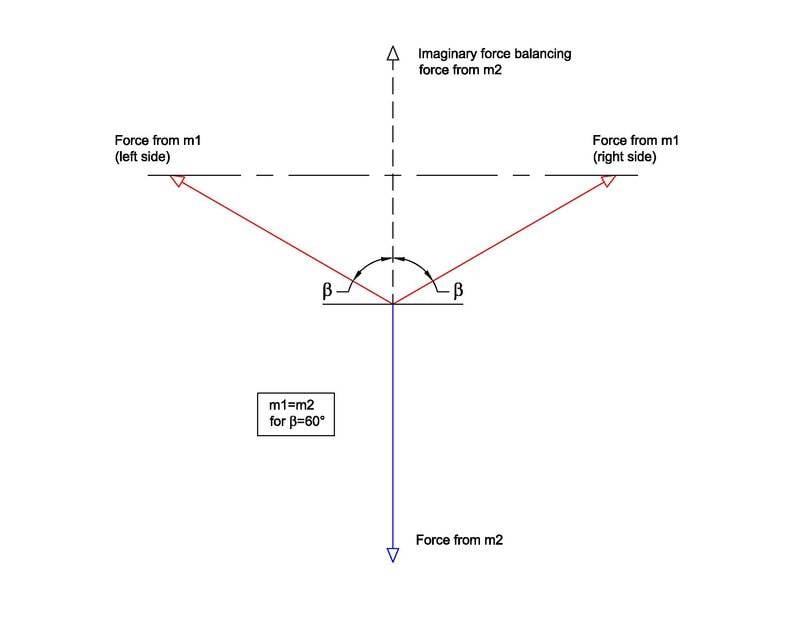

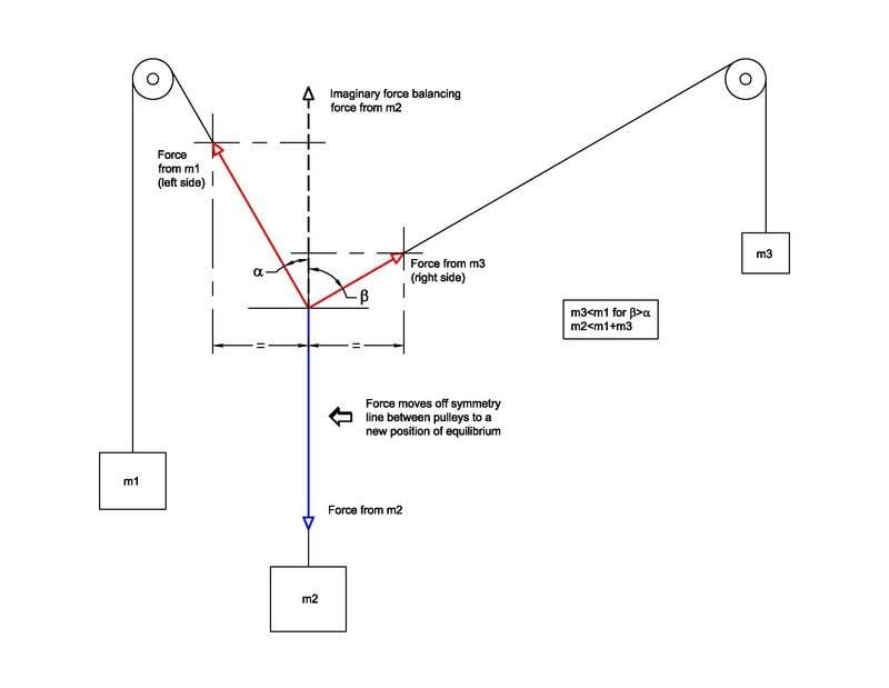

Consider that in problems like this, including non-moving ideal pulleys (no mass, no friction, no translation), their function is limited to modify the direction in which the force is transferred by the rope or string.
You could simplify this particular problem to a summation of vectors representing all acting forces and their lines of action (respect to th ecentral body or mass), which reach a natural state of equilibrium.
Note that the vertical component of each of the two non-vertical actual force or rope tension must be of a magnitude equal to half the actual vertical force (weight of mass 2).
Free-body vector diagram: a downward blue arrow labelled Force from m2 meets two red arrows labelled Force from m1 (left side) and Force from m1 (right side), each at angle alpha from a dashed vertical line; a dashed arrow labelled Imaginary force balancing force from m2 points upward. Boxed note reads m1>(0.5)m2.
Force diagram: a downward blue arrow labelled Force from m2 meets two red arrows from a common point, labelled Force from m1 (left side) and Force from m1 (right side), each at angle β to the horizontal; a dashed vertical arrow is labelled Imaginary force balancing force from m2; boxed note reads m1=m2 for β=60°.
And, as suggested by @kuruman , the asymmetrical case:
Free-body diagram of a two-pulley system with three hanging masses: m1 on the left, m2 hanging from a central junction, and m3 on the right. Red force vectors labelled from m1 and m3 meet a dashed imaginary balancing force, angles alpha and beta marked, and a blue arrow shows the force from m2 pointing down.
[Edit: Incorrect diagram replaced with shown one]

haruspex said:
I think you mean m3<m1 for β>α, m2<m1+m3.
I can’t see that β>60° is of special interest.
Thank you, @haruspex
The posted diagram was incorrect.
I am editing it.
