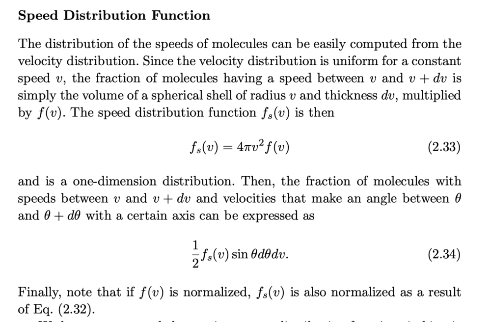

Printed textbook page titled Speed Distribution Function, giving Eq. 2.33 fs(v) = 4pi v^2 f(v) and Eq. 2.34, the fraction with speed between v and v+dv and angle between theta and theta+d theta, equal to one half fs(v) sin theta d theta dv.
Firstly, I would like to check my understanding of the first formula:
Using velocity distribution = f(v), speed distribution = fs(v):
fs(v) = f(vx)f(vy)f(vz)dxdydz, since dxdydz = 4pi*v^2*dv, fs(v) = 4piv^2f(v)
The second formula is the confusing one:
What does it mean? What is the significance/meaning of the "angle"?
Velocity is a vector, which means it has magnitude and direction. As stated, (2.33) gives the fraction of molecules that are within a speed interval and moving at an angle between ##\theta## and ##\theta+d\theta## measured from some axis. Equation (2.33) does not take direction into account and gives you the distribution in all directions.
If you have the distribution ##f(\vec{v})## for the velocity, then you get the distribution for any function of ##u=F(\vec{v})## by
$$p(u)=\int_{\mathbb{R}^3} \mathrm{d}^3 v f(\vec{v}) \delta[u-F(\vec{v})].$$
For the Maxwell-Boltzmann distribution it's easy to calculate, because in this case
$$f(\vec{v})=N \exp[-m v^2/(2 k T)].$$
Then just introduce spherical coordinates ##v,\vartheta,\varphi## and ##F(\vec{v})=v## in the general formula
$$p(u)=\int_0^{\infty} \mathrm{d} v \int_0^{\pi} \mathrm{d} \vartheta v^2 \sin \vartheta N \exp[-m v^2/(2kT)] \delta(u-v)=4 \pi N u^2 \exp[-m u^2/(2kT)].$$
let ##g : R \times R \rightarrow R, (\theta, |v|) \mapsto g(\theta, |v|)##, where ##v \in R^3## and ##|v| = \sqrt{\langle v,v \rangle}##. by spherical symmetrie, ##f(v) = H(|v|)## for some ##H##$$\begin{align*}
\mathbb{P}(a < |v| < b \text{ and } \theta \leq c) &= \int_0^c \int_a^b g(\theta, |v|) d|v| d\theta \\
&\overset{!}{=} \int_0^{c} \int_{0}^{2\pi} \int_a^b f(v) |v|^2 \sin{\theta} \, d|v| d\phi d\theta \\
&= \int_0^c \int_a^b 2 \pi |v|^2 f(v) \sin{\theta} \, d|v| d\theta
\end{align*}$$follow that $$g(\theta, |v|) = 2\pi |v|^2 f(v) \sin{\theta} = \frac{1}{2} \left(4\pi |v|^2 f(v) \right) \sin{\theta} = \frac{1}{2} f_s(|v|) \sin{\theta}$$
