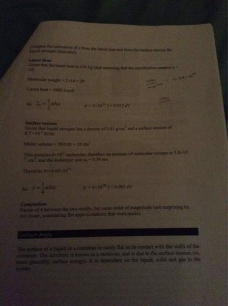

I was looking through my notes and came across this (above) I understand the calculation etc but I don't see where the number of atoms N was calculated?
I don't see where it has come fromAny help would be great thanks in advanced

28 gram is one mole
density is 0.81 g/cm3
so 28 gram is 28/0.81 = 35 cm3, right ? i.e. 35 cm3/mole
one mole is N_avogadro molecules and 35/(6 e23) = 5.8 e-23 cm3/molecule.
Take the ##\root 3 \of \ ## and you get something like 3.9 e-8 cm or 0.39 nm
It's the top calculation for latent heat I'm not sure about I get the surface tension one, but the one above makes no mention of N but must use it:)
Why don't you type the part of "your" notes that you have a question about ? I can hardly read what is to the left of ##{1\over 2} nN\epsilon##. Anyway, since we are talking J/mol, N=NA.
Would N in the top equation not be just Avergadros number?
Yes. Since we are talking J/mol, N=NA.
