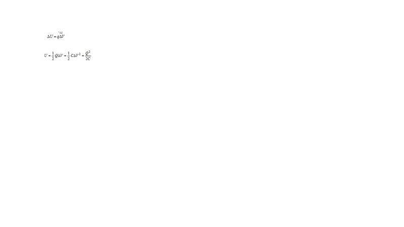

Where did you get the two equations? What was being discussed when they were introduced / derived?
The equations are correct...
Here they are printed from the text.
So why did one of the equations include q while the other included Q.
v and V are different - the first usually means velocity while the second has to do with "voltage"

The first formula looks like it might be the amount the energy of a charge q gains/loses when subjected to a change in V
The second looks like the Energy stored when a capacitor is charged. After the first bit, that you quoted they continue to sub for the value of a capacitor (C) , or at least I assume that is dealing with Capacitors.

I don't see any lowercase "v" anywhere in this discussion :confused:
I agree, that is exactly what that formula is telling us. If (usually point) charge moves through a potential difference ΔV, the formula tells us the change in potential energy.
Yes, that is most certainly the energy stored in a capacitor that has a charge Q on one of it's plates, and a potential difference ΔV across the two plates.

I was pointing out that a lower case v in a formula is quite different to a capital V in another formula. I was bemused that you though that two formulae, one with a lower case q in it, and another with a capital Q in it referred to the same thing.
Particularly surprised that you thought they were interchangeable.
When I asked the question "Perhaps you have written one [or both] of the equations incorrectly?
You replied with "The equations are correct... Here they are printed from the text."
However, the equations from the text were different to your original post ? - they weren't correct!

I believe your final two statements - highlited in blue above - answer your own original post. Of course you have to correct 1. to read ΔU= q*ΔV like the formula you copied from your text.

The half in the second formula can be explained if you think of charging a capacitor, one point charge at a time.
The first charge you transfer is easy - the capacitor is uncharged.
The next one is just that little bit more difficult, as you have to over come the weak electric field you created when you moved the first charge across.
The third charge is just that little bit harder again.
It follows that the last charge you transfer is the hardest to achieve.
On average, the middle or halfway charge best represents the work done to get each charge across, thus the factor of 1/2 in that formula.
