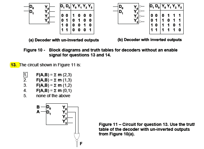

amninder15 Messages 19 Reaction score 0 Thread starter Oct 19, 2012 #1 For this question Why is the answer not m(0,1)? Little confused here. Any help will be appreciated. Thanks Attachments Capture_Decoder.PNG 11.3 KB · Views: 617

berkeman Admin Messages 69,769 Reaction score 25,618 Oct 19, 2012 #2 amninder15 said: For this question Why is the answer not m(0,1)? Little confused here. Any help will be appreciated. Thanks I think it's because the output gate is a NOR rather than an OR. Now what do you think the right answer is...?
