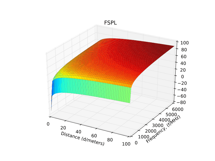

It originates from the free space path loss (FSPL), which is
\begin{equation} \text{FSPL}\ [\text{dB}] = 20\,\log{f} + 20\,\log{r} - 147.55. \end{equation}
Interestingly, the Wikipedia page also reports a similar graph for FSPL alone:
(Sss41 (2014). Free-space path loss. Wikimedia. Free-space path loss plot.)​
