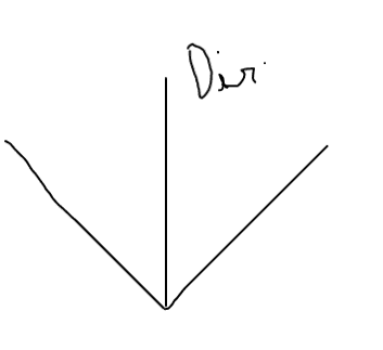

What I was thinking of the image is
Although, I was thinking why phi roof is perpendicular.
I was trying to understand that direction by the vector direction. I can't figure out that direction. Usually, I didn't do any vector of angle. I was wondering I didn't find any tutorial of angle direction in YT.
What's the question exactly?
Start with ##\vec r = r(\cos \phi\,\hat i + \sin\phi\,\hat j)## and find the direction of ##\partial \vec r / \partial \phi##.
If I differentiate that then, I get
$$\frac{\partial \vec r }{\partial \phi}=r (\cos \phi \hat j - \sin \phi \hat i)$$
But, I was thinking what I should do with the equation. 🤔

What happens if you take the dot product of that with ##\hat r##?

Show that vector is orthogonal to ##\vec r##
How? :thinking Did you mean to graph?
You could use the dot product - correctly, of course.
To me $$\hat r r$$ represents the direction of phi is toward r. But, I think $$(\cos \phi \hat j - \sin \phi \hat i) \cos \theta$$ this are representing direction of phi is perpendicular. But, I am saying that by looking at original picture. Without that, I can't say that. So, how can I see that that's really perpendicular. 🤔
Note that it's either ##\phi## or ##\theta##, not both. Also, look up the dot product in Cartesian coordinates and note that:
