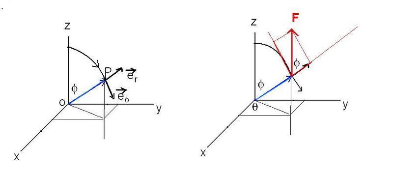

So the full problem reads: A vector F has the same magnitude and direction at all points in space. Choose the z-axis parallel to F. Then , in Cartesian coordinates, [tex]\vec{F}=F\hat{z}[/tex], where [tex]\hat{z}[/tex] is the unit vector in the z direction. Express [tex]\vec{F}[/tex] in spherical coordinates.
I don't know?
Well pretty much it wants me to express this vector field that is parallel with the z-axis, which really means converting [tex]\hat{z}[/tex] to spherical coordinates.
I found the answer to be [tex]\hat{z} = cos(\phi)\hat{r}-sin(\phi)\hat{\phi}[/tex] through an online resource I really didn't understand. No images, nothing. Can someone please explain how you can convert the unit vectors to spherical?
And would the answer be [tex]\vec{F}=F\hat{z} = F(cos(\phi)\hat{r}-sin(\phi)\hat{\phi})[/tex]

Yes, you are done! resolving the Cartesian unite vector z into its spherical polar coordinates yields
you just need to substitute the above equation into the relation [tex]\vec{F}=F\hat{z}[/tex].
So: [tex]\vec{F}=F\hat{z} = F(cos(\phi)\hat{r}-sin(\phi)\hat{\phi})[/tex] is the answer?
But my question was if someone can explain why [tex]\hat{z}= cos(\phi)\hat{r}-sin(\phi)\hat{\phi}[/tex]

See the picture. The unit vectors of the polar coordinates change with the position. At point P, ##\vec e_r## or ##\hat r## is the unit vector along the radial vector pointing to P from the origin. ##\vec e_Φ## or ##\hat Φ## is the unit vector perpendicular to ##\hat r## in the plane of the z axis and OP.
If you have a vector ##\vec F## at P, its projection onto the direction of the unit vectors are its components in polar coordinates.

Yes, but just to harmonize this with future exploits, be aware that naming of spherical coordinates is almost always
##\theta## polar angle : ##\arccos (\hat z \cdot \hat r)##
##\phi## azimuthal angle : ##\arccos (\hat x \cdot \hat r)##
i.e. just the other way around. Better get used to that.
