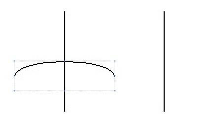

Hi,
I am trying to draw an arc at the top of two parallel lines i.e connecting two coordinate (130, 170) & (230, 170) using the function below. I can't understand how to start the arc at a particular point.

Instead of eq i have a function:
public abstract void fillArc(int x,
int y,
int width,
int height,
int startAngle,
int arcAngle)
g.drawLine(130, 170, 130, 270);
g.drawLine(230, 170, 230, 270);
g.drawArc(80, 220, 100,30, 0, 180);
I have stored my result in the image. Some body please guide me,
Zulfi.
It looks like the upper left corner of the rectangle in the picture below is the x,y coordinate for g.drawArc. And I think that the coordinate system is such that x starts from 0 on the left edge and increases to the right, and y starts from 0 on the top and increases downward.
If the last parameter in g.drawArc was 360, you would get an ellipse that fills the whole 100 by 30 rectangle.
So it looks like x has to increase to move the arc to the right, and y has to decrease to move the arc upward.
I'm not positive that I am right on this. Let me know what you find out.
I do not understand how you arrived at those x and y values for the arc. From the description, it seems like they should be 180, 170, i.e. the coordinates of the point half way between the two points you are trying to connect.
