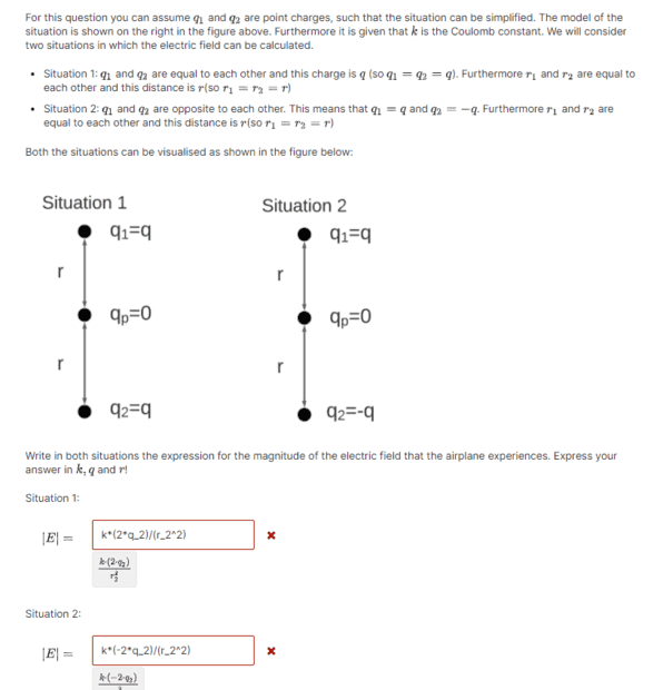

I have the above question and I think I am now understanding it.
We know that
E=F/q
F= K * ((q1*q2)/r^2)
So E = K * ((q1*q2)/r^2*q)But as we need to find the E at point q_p
I'm thinking for solution 1,
E = (K*(q/(r^2*q)))*2 as the forces are equal,
And for solution 2
E = K*(q/(r^2*q) - K*(q/(r^2*q)
Am I barking up the wrong tree?

You mixed up things a bit ...
To put things in some order:
Assume a positive charge ##q'## is in the middle. Then for each of the two cases do:
  • Calculate force ##F_1## from ##q_1## to ##q'## both in magnitude and direction
  • Calculate force ##F_2## from ##q_2## to ##q'## both in magnitude and direction
  • Calculate the electric field ##E_1=F_1/q'## from ##q_1## both in magnitude and direction
  • Calculate the electric field ##E_2=F_2/q'## from ##q_2## both in magnitude and direction
  • Calculate the total electric field which will be ##E=E_1+E_2## if ##E_1,E_2## have the same direction, or ##E=|E_1-E_2|## if ##E_1,E_2## have opposite directions (the bars stand for the absolute value).

The question refers to a diagram "… shown on the right in the figure above". This is missing - it is not possible to tell if it is important or not.
This is a badly worded question because the diagrams for Situation 1 and Situation 2 show ##q_p=0## (I assume ##q_p## is the charge on the airplane). This means the airplane experiences no electric field even if an electric field is present (assuming we can ignore induced charges).
Presumably you are being asked for the electric field’s magnitude at the position of the the airplane.
For Situation 1, consider the symmetry. Any charge at the mid-point will experience two equal magnitude forces in opposite directions. What does that tell you?
I got the answers nearly correct, but for the wrong situations :(
for situation 1 answer is 0,
For situation 2, the answer is 2*k*q/r^2
Thanks for your help :)

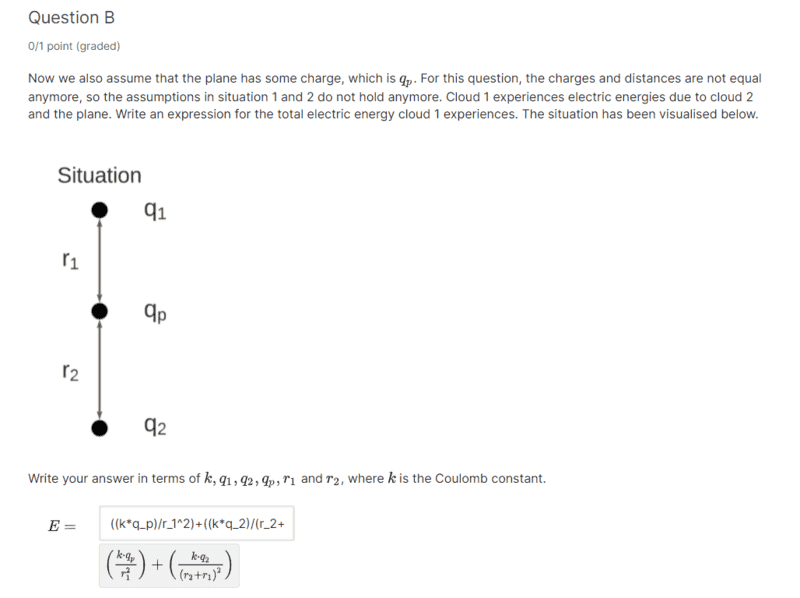

So I Know
E=F/q
F = k*q_1q_2/r^2
So k*q_1*q_2/r^2*q
so to rewrite I have put the sum of the 2, making sure q_2 acts at r_1+r_2^2
((k*q_p)/r_1^2)+((k*q_2)/(r_2+r_1)^2)Is this looking correct?

Judging from the likes, @Steve4Physics and @Delta2 interpret the above post as saying you have now seen how to get the right answers. I read it as saying you are still getting them swapped over.
What you are overlooking is that q1 and q2 are on opposite sides, so if they are like charges their fields oppose and if they are opposite charges their fields add. Draw arrows for the field directions.

I'm confused both by the question and your attempt.
What does it mean by the "electric energy experienced" by a body? Does it mean the force, the field, or the potential energy?
In your attempt, you write the expression for the force cloud 2 exerts on cloud 1, but end up with the expression for the field cloud 2 and the plane produce at cloud 1.

No. It is completely wrong and seems to have nothing to do with the question.
I agree with @haruspex that the question is badly written. Can you tell us what course you are on and where the question is from?
If you have 2 point charges, Q1 and Q2, separated by a distance ##d##, what is the standard formula for the electrical potential energy stored? If you don't know, refer to your notes and/or textbook. Then post your reply.

the answer is apparently
k*(q_1*q_p/r_1 + q_1*q_2/(r_1+r_2))
It is a physics course on edx called pre university physics.
Looking at the difference, my answer is no a million miles away, but you make one mistake in physics and it doesn't really matter.
The question started in a new thread, but got moved into this pre-existing thread, but an administrator.
Ok, that shows the question wants the net electric potential energy of the plane.
The EPE of a charge is its charge multiplied by the electric potential at its location.

That's not really true. A mistake (in physics or elsewhere) can be small or big. The mistake you made was fundamental, indicating you didn't really undertsand some basic physics.
It's a bit like confusing velocity and acceleration. It may appear to be a small mistake (e.g. units are m/s and m/s²) but the meanings are very different.
You used a formula giving force instead of the formula giving energy. Though the formulae look similar and are related, they mean very different things.
You never answered the question I asked in Post#8. Here is the question, slightly revised, if you would like to answer it:
You have 2 point charges, Q1 and Q2, separated by a distance d.
What is the formula for the force exerted on each charge?
What is the formula for the electrical potential energy stored?
Refer to your notes and/or textbook if required. And post your reply.
