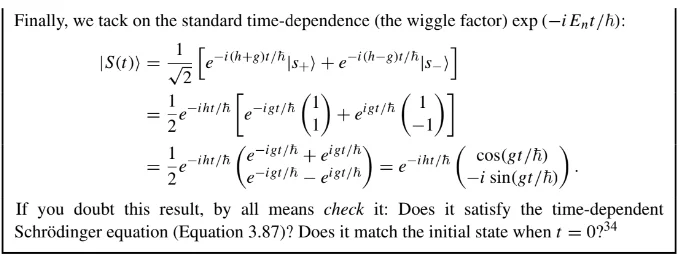

Part (c) is where I am having problems. In a previous example the author just "tacks on the time wiggle factor"
$$| S(t) \rangle =
c_3
\begin{pmatrix}
0 \\
0 \\
\end{pmatrix} e^{-2i\lambda t / h}
\frac{c_1 + c_2}{\sqrt{2}}
\begin{pmatrix}
1/ \sqrt{2} \\
1/ \sqrt{2} \\
\end{pmatrix} e^{-i\lambda t / h}
\frac{c_1 - c_2}{\sqrt{2}}
\begin{pmatrix}
1/ \sqrt{2} \\
-1/ \sqrt{2} \\
\end{pmatrix} e^{i\lambda t / h}

The example I refereed to earlier in the problem is here:
the author is clearly tacking on eigenvectors rather than that of the coefficients of the initial state. Indeed if I apply my method above by tacking on the wiggle factor to the components of the initial state I get an incorrect answer...
I am quite confused.

hmparticle9 said:
This is not correct.
What is not correct?
You found the correct eigenvalues ##\lambda_k## and the corresponding eigenvectors ##|\psi_k\rangle.##
You tacked on the "wiggle factor" to get $$| S(t) \rangle =\sum_k c_k | \psi_k\rangle e^{-\lambda_k t/\hbar}.$$ It follows that the expectation value takes the form $$ \langle S(t)|A| S(t) \rangle =\sum_l \sum_k {c_l}^* c_k \langle \psi_l|A | \psi_k\rangle e^{+\lambda_l t/\hbar} e^{-\lambda_k t/\hbar}$$ $$ = \sum_l \sum_k {c_l}^* c_k\lambda_k \langle \psi_l | \psi_k\rangle e^{+\lambda_l t/\hbar} e^{-\lambda_k t/\hbar} $$ $$ = \sum_l \sum_k c^*_lc_k\lambda_k \delta_{kl} e^{+\lambda_l t/\hbar} e^{-\lambda_k t/\hbar} = \sum_k c^*_k c_k\lambda_k e^{+\lambda_k t/\hbar} e^{-\lambda_k t/\hbar}$$ $$=\sum_k |c_k|^2\lambda_k$$ as expected.
Once you find the eigenstates, you tack on the "wiggle factor" to them and forget all about the initial state because the original matrix is not diagonal and its basis states are not eigenvectors of ##A##. See post #2 about how it's done. Maybe that's the source of your confusion.

What is the Hamiltonian of the system? The Hamiltonian determines how a state evolves in time. I don’t think ##\hat A## is the same as the Hamiltonian. Is the matrix representing ##\hat A## written with respect to the energy eigenstates?
Okay I have made a major error here. I was treating the matrices as separate problems. There are three matrices ##H, A## and ##B##. How do you suggest I proceed?
Really sorry guys, I feel like a complete tool.
"The Hamiltonian determines how a state evolves in time". The penny dropped.
Good point. I missed that.
Yes I did :)
After your post it clicked immediately: The Hamiltonian determines how a state evolves in time. I was treating the observable ##A## as the Hamiltonian.
