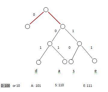

Huffman code?!?
Hi there!:smile:
Im having abit of trouble getting my head around this question concerning the Huffman code,the average length of an encoded symbol etc...
:confused:
the full question is attached!...help would be v. much appreciated!

The problem reads:
"Consider the symbols and frequencies:
[itex]e:0.36\;\;a:0.14\;\;d:0.26\;\;s:0.24[/itex]
(a) Find the Huffman code, and the average length of an encoded symbol.
(b) Give another prefix code for the symbols a, e, d, s. Compare the average lengths of an encoded symbol for the two codes."
So, what have you done on the problem so far? Seems straightforward enough to me.
So far iv drawn the tree for the code concerned (attached image!)...however I am not sure whether it looks correct?? I am not sure about the bits in red?!?
im not sure which of the following to use:
d: 100
a: 101
s: 110
e: 111
or
e: 0.36 - 0
d: 0.26 - 10
s: 0.24 - 110
a: 0.14 - 111
