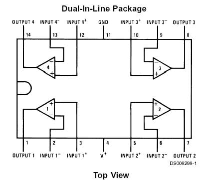

There are integrated circuits with multiple operational amplifiers in one package. e.g. this dual-in-line package (DIP) of the LM324.

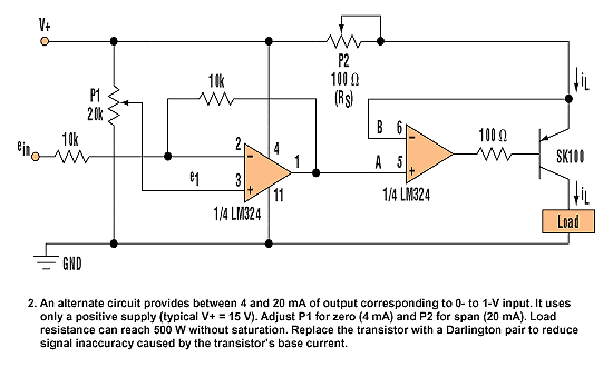

When drawing a schematic of a circuit that uses more than one op-amp from a package, you really only need to show the power input pins on one. e.g. this circuit using two amps of the quad op-amp package (each labeled as 1/4 LM324 with power pins 4 and 11 shown on only one).
