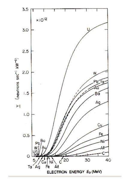

Usually, electron-beam oncology is by production of bremsstrahlung (photon) radiation, by stopping the electron beam in a high-Z (usually tungsten) target. High-Z collimators (also tungsten) are used to control the size and shape of the irradiated area. Tungsten is especially useful for a collimator because of its high density.
All elements have a photo-neutron cross section (γ,n) for producing free electrons. With few exceptions, the High-Z materials like tungsten have a lower threshold (6 to 8 MeV) and a higher "giant dipole resonance" peak neutron production cross section, sometimes over 1 barn per atom. This photo-neutron production greatly increases with electron-beam energies over 8-10 MeV, and effectively limits the electron beam energy used for electron-beam oncology. Usually, the direct electroproduction of neutrons is much smaller, when compared to the electron-bremsstrahlung-photoproduction channel..
See thumbnail of neutron yields vs. electron beam energy in thick bremsstrahlung targets. Note that only uranium has a higher photoneutron yield than tungsten.
From http://www.google.com/url?sa=t&sour...puG6CQ&usg=AFQjCNFDwgclxNI5B5_Li3phSoXsuzy69g

excellent - thanks! :)
