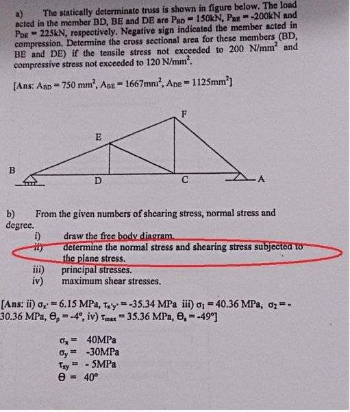

For part b , i think one of the angle either $$\theta_s$$ or $$\theta_p$$ is wrong
For the second question , what is plane stress ?
[/B]
1.) Because in mohr's circle, the maximum shear stress on the vertical axis , for the maximum normal stress , it's on the horizontal axis , right ?
  • Handwritten-style worksheet page showing a statically determinate truss diagram with members labelled B, D, E, F, C and A, and part b listing four items with item ii circled in red; below it a box lists sigma x = 40 MPa, sigma y = -30 MPa, tau xy = -5 MPa and theta = 40 degrees.
I am sorry that the title of the topic is confusing . I think the part a is not related to part b
