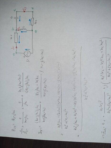

Hello. So, I have an AC circuit in front of me. What I need to do is pull out the formula for inductance of the inductor as L = f(C, R2, w0) and w0 =f(C, R2, L) by calculating the total impedance of the circuit. It's a voltage resonance example so it is supposed to be done by using the term Im(Z)=0. I'm not sure if I did it correctly so I'm asking for help.
XL = w0*L
XC = 1/(w0*C)
Here's my attempt at a solution.

Well, the images are coming out small, dim and sideways. It's better to post a PDF file attachment showing the problem statement, and type your work into the forum using LaTeX. See the LaTeX Guide link in the lower left of the Edit window.
While you are learning LaTeX, can you at least post much better/bigger versions of the schematic drawings and separately post pictures of your work? Be sure to post them upright instead of sideways, and when you attach them, select "Full Size" instead of "Thumbnail". Thanks.

Hard to "decipher" your hand writing. I can only tell you what I get. I get a quite complex expression for Im(Z), but at the end of the day the condition ##Im(Z)=0## simplifies to $$L=C(\frac{1}{C^2\omega^2}+R_2^2)$$ from which I get that $$\omega=\frac{1}{\sqrt{C(L-CR_2^2)}}$$
