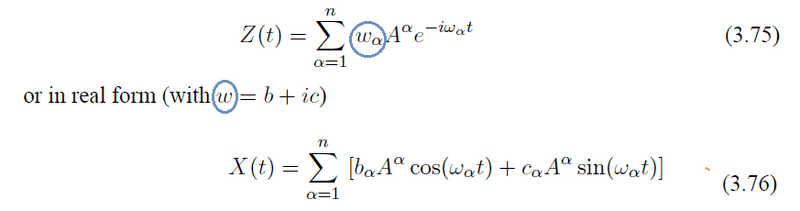

Why are ##\omega_\alpha## being used as "arbitrary coefficients" in (20)?

If these calculations are correct then it seems that the answer to my last question in the OP is that ##\omega_\alpha## used in the book is a typo.
This looks good to me.
The textbook writes
If you look closely, the symbol that I circled in blue is the script letter for w rather than the Greek letter ##\omega##. Unfortunately, the font chosen for the book's printing makes these look almost identical.
