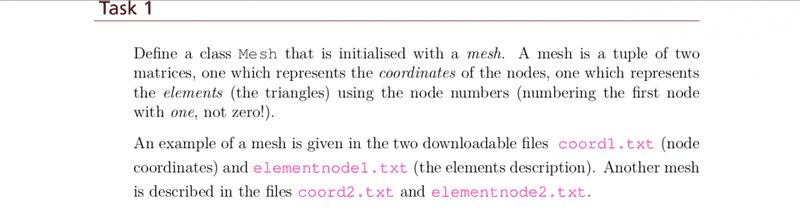

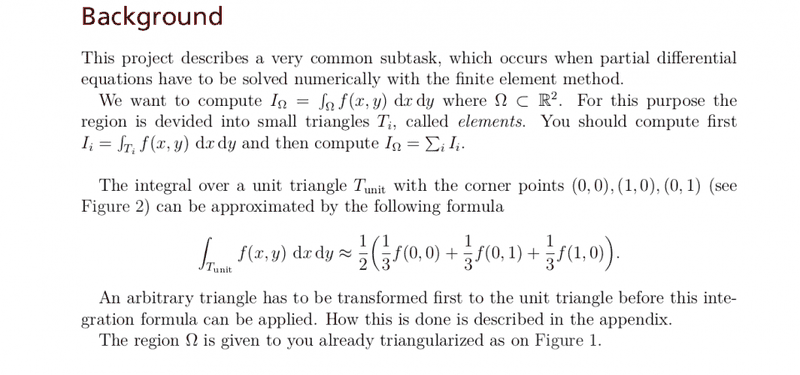

Hi,
I have a python project to do that related to building a mesh class that represents triangles.
(I am a bachelor student of mathematics in my first year, so all this material is pretty new to me)
I should get as an input two matrices:
*one which represents the coordinates of the nodes.
*one which represents the elements(triangles) using the node numbers.
My problem is that I really don't know what it is node numbers. How do they numbered?
I have attached the file of the project
I really can't start doing it without understanding those words and what do the numbers in the matrices represent.
Thank you,
Thomas

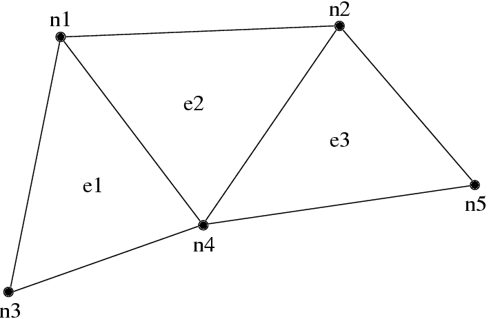

This is a picture of a simple region which has been divided into triangles:
There are three triangular elements: e1, e2, e3
There are five nodes: n1, n2, n3, n4, n5
Since this is a two-dimensional region, there will be two numbers used to specifiy each nodal coordinate (x,y)
For instance:
Code:
Node     x    y
   1     x1  y1
   2     x2  y2
   3     x3  y3
   4     x4  y4
   5     x5  y5
The elements can be described using just the node numbers, so that you don't need to repeat using the actual coordinates:
Code:
Element    Node 1   Node 2  Node 3
   1          1        3       4
   2          1        4       2
   3          2        4       5
By setting up data tables, when the program needs access to information about element 1, it sees a list of three node numbers, each of which in turn can be accessed to give the coordinates of the nodes for that element to use in subsequent calculations. This keeps storage for the description of a region to a minimum.
Since there will be a discrete number of nodes and elements, there's no need to use floating point numbers to access them. Only the coordinate values need to be floating point.
Your data files are difficult to read because all the data is written onto one long line of text. This might be easy for a computer program to read, but it's hard for a human to interpret, unless one knows how the data were originally arranged and written to the file.

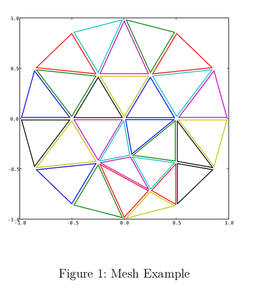

The file 'coord1_1.txt' contains 2 lines and 21 columns. The first line contains all the x-coordinates and the second line contains all the y-coordinates. There are 21 columns, representing 21 points. In the file 'elementnode1_1.txt', the connectivity of the triangles are described. This file contains 3 lines and 28 columns. Each column represents a triangle and the number refers to the columns in 'coord1_1.txt'.
The first column in elementnode1_1.txt says:
So this triangle is the triangle (-0.866, 0.5), (-0.5,-0.866),(-0.25,-0.433)
