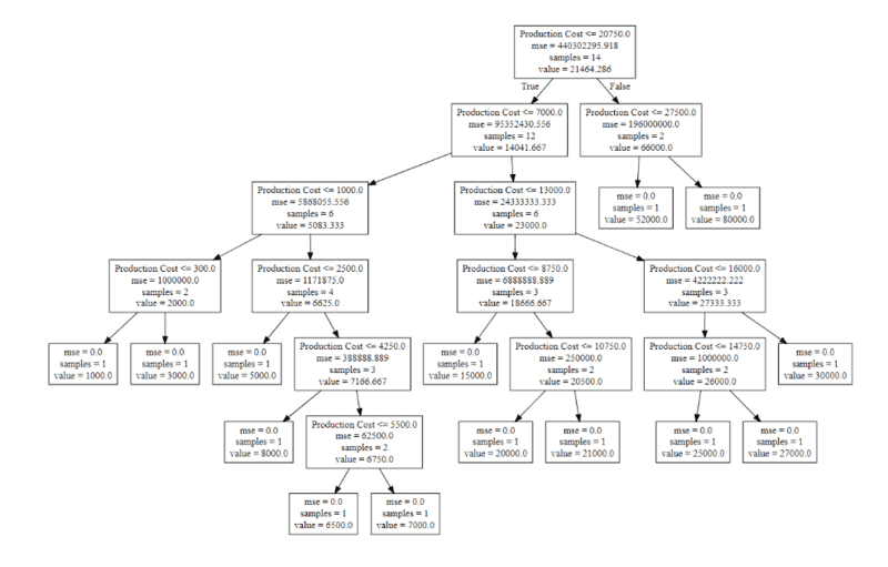

Thank you. Let me see if I understand correctly. In the example figure below, I notice that the leaf nodes have specific amounts, i.e. the value (last line). What if the inputs are such that the predicted value is none of the values mentioned in the leaf nodes? That is my dilemma. It seems that there is a finite number of leaf nodes having their own value...

After some research, I learned that, in the case of a regression decision tree, the possible numerical output answers are the averages of the values for those instances in the training dataset that together reached a particular leaf node based on the sequence of if-then statements along the tree itself...
