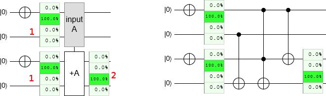

Did you try searching for an answer? When I google "How does does a quantum computer do 1+1" I get results from the quantum computing stack exchange such as "How does a quantum computer do basic math at the hardware level?" and even "How do I add 1+1 using a quantum computer?".
The addition circuit is one of the example circuits in Quirk:

If I want to make one plus one, and possibly get two as a result, what should I do?o_O
You need to encode your two numbers as, say, little endian 2s complement. Then you apply an addition circuit to them. Then you look at the output and interpret it as a little endian 2s complement integer. You can either use the built-in adder gate or use one constructed from controlled-NOT operations.
Thank you. Very interesting... So Quantum Computer say: "one plus one make two" Excellent!
