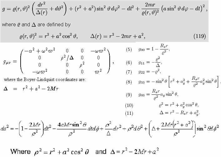

According to Wikipedia, the equation for the Kerr metric is:
[tex]c^{2} d\tau^{2} = \left( 1 - \frac{r_{s} r}{\rho^{2}} \right) c^{2} dt^{2} - \frac{\rho^{2}}{\Lambda^{2}} dr^{2} - \rho^{2} d\theta^{2} - \left( r^{2} + \alpha^{2} + \frac{r_{s} r \alpha^{2}}{\rho^{2}} \sin^{2} \theta \right) \sin^{2} \theta \ d\phi^{2} + \frac{2r_{s} r\alpha \sin^{2} \theta }{\rho^{2}} \, c \, dt \, d\phi[/tex]
However, according to four other references listed in Reference and equations listed as attachment for brevity, the 'Delta/Lambda' function is not squared within the metric?
[tex]\frac{\rho^{2}}{\Lambda^{2}}[/tex] ?
Which equation reference is the correct equation solution for the Kerr metric?

I have checked the Wikipedia reference, the first two links that you give after Wikipedia, and two references that I happened to take home tonight, and all (including Wikipedia) agree on the form of the Kerr metric.
What most references call [itex]\Delta[/itex], Wikipedia calls [itex]\Lambda^2[/itex]. When these symbol are replaced by their defining expressions, everything works out the same.
