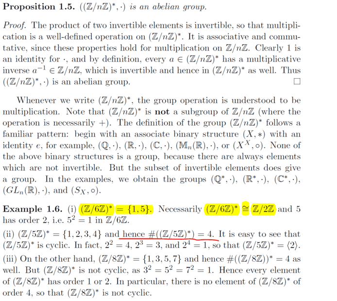

Kindly see attached notes
...Out of interest am trying to go through the attached notes,
My interest is on the highlighted, i know that in
##\mathbb{z}/\mathbb{6z}## under multiplication we shall have:
##1*1=1##
##5*5=1## am assuming that how they have the ##(\mathbb{z}/\mathbb{6z})^{*}={1,5}## is that correct?
In ##\mathbb{z}/\mathbb{5z} ## we shall have,
##1*1=1##
##2*3=1##
##3*2=1##
##4*4=1## .....integral domain...
insight or guidance is welcome...
Now the part i am not getting is the highlighted part in red.
Cheers.
The star in the notation means, the (multiplicative) group of units (invertible elements) in the ring. In the case of ##\mathbb{Z}_6,## we have only two units, ##1## and ##5##, because there is no solution to the equations ##a\cdot x=1## if ##a\in \{0,2,3,4\}.## You are right, ##1\cdot 1= 1## and ##5\cdot 5=1.## There is only one group with two elements, so ##\mathbb{Z}^*_6 =\{1,5\}\cong \mathbb{Z}_2.##
##\mathbb{Z}_5## on the other hand is a field because ##5## is a prime number. As a field, all elements except ##0## are units, i.e. ##\mathbb{Z}^*_5=\{1,2,3,4\}.## You have found all the inverse elements. The words you highlighted in red simply mean that the number of elements in ##\mathbb{Z}^*_5=\{1,2,3,4\}## is four: ## \# \mathbb{Z}^*_5=\# \{1,2,3,4\}=|\{1,2,3,4\}|=4.##
...so in simple terms for a set to be defined as a field,it means that every element in that set must have an inverse like in the case of ##\mathbb{z}_5?##. In ##\mathbb{z}_6## the elements ##[2,3,4]## have no inverse, thus not a field... or in other terms a lack of zero divisors...need to review the definitions...
