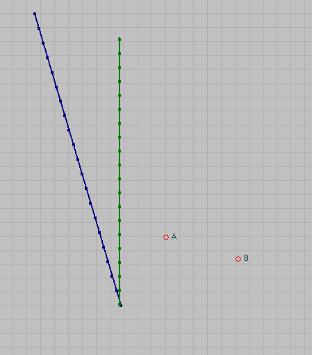

Yesterday I was reading a book about special relativity, It focused a lot about consequences of the theory, but there's only one thing I couldn't understand, which is as the title suggests, Relativity of simultaneity, that two different observers can't agree if two event are simultanious, I understand Einstein's thought expirement, but I get often confused about it, for example Imagine an observer at rest, let's name it A, whose origin is O, now draw the (x,t) space-time along with A's world line and O, let's place a point G in Elsewhere (Not in the absolute future or past of O), how can I draw the wordline of a moving observer B passing through O that record O and G to be simultanious,

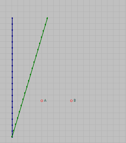

I think what is meant can be seen more clearly on a space-time diagram. In this plot, time is the vertical axis and x is a spatial dimension on the horizontal axis.
The first image shows the events and worldlines in the coordinates of the blue worldline and second is in the coordinates of the green WL. The events A and B are simultaneous in 'blue' coordinates but not in 'green' coordinates. The two diagrams are connected by a Lorentz transformation.

Mentz, I guess I'm missing something here. Don't you have the relative vertical positions of A and B reversed in the second drawing?. In other words, is it not appropriate to simply rotate the entire 1st picture so that the green goes vertical?
In the first picture, the green observer's x and t axes don't intersect at a 90-degree angle, and that property will be preserved if you just rotate the picture to get the green axis vertical. That's a valid picture, but it's not the one that's usually drawn, and it's not the one that Mentz drew. Try drawing lines of constant green t (hey - that sounds funny when you say it :smile:) through the points A and B, see where they intersect the green t axis, and that will give you the right vertical relationship.
I guess I'm particularly dense this morning. What I'm interpreting from the first picture is that blue sees A and B happening at the same time whereas green in that pic sees A first and then B. The second pic shows green seeing B happening first, which seems wrong to me.
The diagrams are correct and can be switched by a Lorentz transformation.
In the first picture, the lines of constant green t slant from bottom left to top right, so the line of constant t (all events on such a line are simultaneous in the green frame) that passes through B is lower on the page and intersects the green t axis below (earlier) than the line that passes through A.
If you draw both t axes in both pictures, it will be clear.
