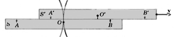

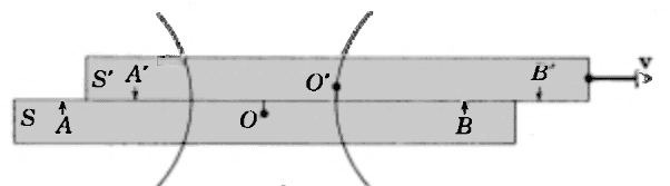

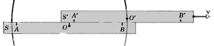

The book then shows a few pictures from the point of view of observer S.
Here we see the light waves from event B arriving at observer S' (who has moved a bit to the right)
and here, at a later time, we see the waves from both events arriving at observer S.
at an even later time, the light from event A arrives at observer S'
One thing that I find confusing here is that ##A'## and ##B'## are moving relative to S and at rest relative to S'.
My impression is that the explosions (or lightning bolts) occurred at some specific location in spacetime that is independent of the frame we are using to give that location coordinates. I would have thought that frame B would be moving away from A and A' and moving towards B and B' (before passing these locations and then moving away from them).
After all, the light signals originated at A and B in frame S (which in frame S' are points with velocities ##-\vec{v}##.
Okay, moving on.
The signals arrive at 0 at the same time (as measured from the clock at 0) and so A and B are simultaneous in frame S.
The S'-observer, however, finds that event BB' precedes event AA' in time; they are not simultaneous to him.
Why is the book calling the events BB' and AA' now?
I get that the light signals do not arrive at the same time at the S'-observer. In other words, they arrive at the S'-observer at different times (as measured by frame S' clock at 0' when the signals arrive).
But this BB' thing and the moving B' is bothering me.
After rereading the book, here are some facts that I failed to consider.
The observers note that two lightning bolts strike each, hitting and leaving permanent marks in the frames.
Are there four lightning bolts or two in total?
I'm inclined to think there are two lightning bolts in total.
It's not clear what "leaving permanent marks in the frames" means in practice, but in theory it seems to mean that the marks for a frame are at rest relative to that frame.
Imagine that observer S is on a spaceship that is located between A and B, and observer S' is on another spaceship located between A' and B'.
Now, I guess we have to assume that the spaceships can overlap in space.
Then, two lightning bolts strike the spaceships at each end. As the S' spaceship moves right, the marks left on the spaceship remain in the same position relative to that frame.
Is this a valid explanation?
This explains the movement of ##A'## and ##B'## in frame S.
A. Einstein described this scenario with a long train passing an embankment.
The left lightning stroke may cause a mark A on the embankment and a mark A' on the train.
The right lightning stroke may cause a mark B on the embankment and a mark B' on the train.
Einstein's book "Relativity: The Special and General Theory", Part I, Section 9 - The Relativity of Simultaneity:
https://en.wikisource.org/wiki/Rela..._I#Section_9_-_The_Relativity_of_Simultaneity
