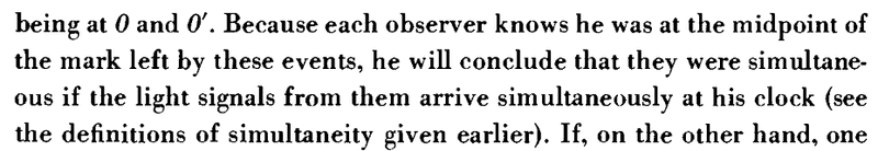

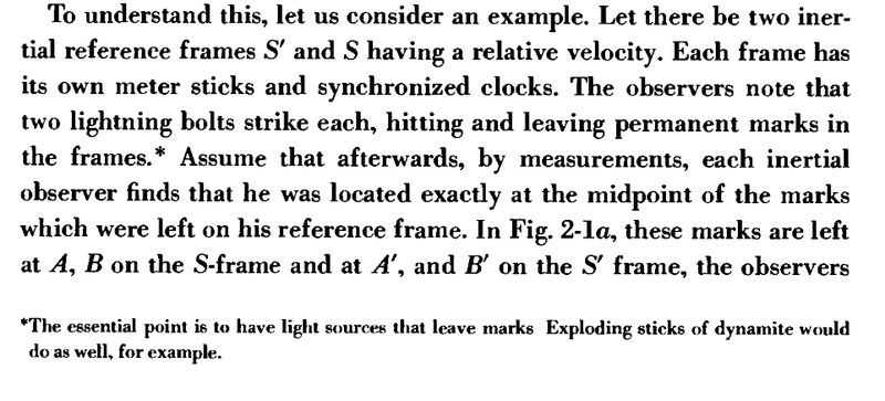

I'd like to understand a section of a book I am reading ("Introduction to Special Relativity" by Resnick).
I will create a series of posts that go through snippets of the section "relativistic kinematics" of the book and try to interpret the content in my own words and perform certain calculations that were left for the reader to do.
I'm going to go step-by-step through the reasoning. If there is any mistake, then it is a true mistake because I am trying to make each statement that follows as accurate as I can.

Some "obvious" methods of synchronizing clocks turn out to be erroneous. For example, we can set the two clocks so that they always read the same time as seen by observer A. This means that whenever observer A looks at the B clock it reads the same to him as his clock.
The book seems to be mixing the names of the events here (A and B) with the names of the observers (ie, frames).

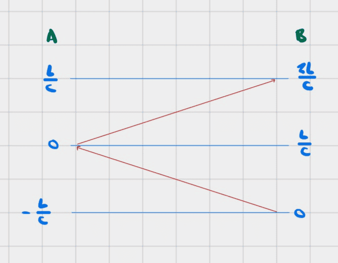

Let me try to show this result.
Observer A is at the location of event A and suppose the clock says zero.
A light ray takes ##L/c## to arrive from the location of event B.
Observer A "seeing" the clock at event B means that he sees light arriving from clock B (presumably through a telescope).
Thus, for observer A to see the clock at event B showing zero when clock A is showing zero, the light ray had to leave event B (showing time zero) when clock A time was ##-L/c##.
Thus, the clocks are not really synchronized: observer A simply sees the clocks as showing the same time at any given time in his frame, but he is actually seeing the time at clock B at ##L/c## in the past: clock B is really ahead by ##L/c##.
Now, whenever light moves from clock A to clock B, it starts at a time that is ##L/c## behind clock B and then takes ##L/c## to arrive, so that when it arrives it is ##2L/c## behind clock B.
Thus observer B observes clock A to be ##2L/c## behind clock B.
Here is a pictorial depiction of this
No. It is talking about two observers and only one frame (see my comment on this above). The book has previously used A and B to refer to events--so by implication, we expect observer A to be co-located with event A and observer B to be co-located at event B.

zenterix said:
for observer A to see the clock at event B showing zero when clock A is showing zero, the light ray had to leave event B (showing time zero) when clock A time was ##- L / c##.
Here you are assuming a simultaneity convention, i.e., a way to define at what "clock A time" an event that is not co-located with observer A happened. But we don't yet know, at this point in the book's exposition, how to define such a convention. Nor is the book using one at this point.
The actual argument underlying the book's statement that you quote is that, if observers A and B are at rest relative to each other (which is implied by the fact that they remain at spatial locations A and B in the same frame), and a distance ##L## apart, then light will take a time ##L / c## to travel between them. This says nothing about "clock A time" for the light leaving B. It just says how much time the light takes to travel, which is given by the known distance ##L## and the fact that light travels at speed ##c## in all inertial frames.

zenterix said:
the final result is that if you adopt this convention, then observer B's clock must be ahead by ##L / c##
More precisely, ahead by ##L / c## as compared to the standard simultaneity convention for inertial frames in SR.
zenterix said:
what observer B sees is clock A being ##2L / c## behind his clock.
Yes.
