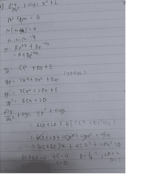

i gt stucked here ... how to continue ? what's wrong with my working ? i found 2 values for D , whcih is wrong

Your selection of yp is confusing. It is recommended that if the RHS is a polynomial of order n, then yp = a general polynomial of order n, not order n+1.

then , what is the correct yp ?
i choose my initial yp = cX^2 + Dx + E , nut i found that the term E is similar to the A , so i multiply the initial yp with x , to get my new yp

A and E are solitary constants. You don't need to multiply your initial choice of yp by x.
Your difficulty is that your solution to the associated homogeneous equation is wrong! The associated homogeneous equation is y''+ 4y= 0 which has characteristic equation m^2+ 4= 0 with solutions 2i and -2i. You have written the characteristic equation as m^2+ 4m= 0 which has solutions m= -4 and m= 0. That would correspond to differential equation y''+ 4y'= 0.

i have redo the question , i got Acos2x + Bsin2x +0.25x^2 + 3/2 , but the ans given is Acos2x + Bsin2x +0.25x^2 +3/8

Check your arithmetic or provide your work to obtain this solution.

i have attached the working in the picture uploaded above

I deleted the picture you attached. It was extremely hard to read, with the top so dark it was nearly impossible to read, and portions were cut off.

It's gone now. We would prefer that you show your work here in the input pane, rather than in a poor quality image with bad lighting and information cut off.
