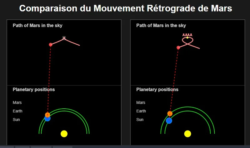

  • #33
@PeterDonis,
I still don't understand why the speed would change the amplitude.
PeterDonis said:
Under those conditions, the problem should be time symmetric about the time of opposition: i.e., Mars's apparent retrograde motion should start some time before the time of opposition, and should end exactly the same time after the time of opposition.
There seem to be a problem here : Mars's apparent retrograde motion can only start at the opposition (but the hole loop should indeed start before the opposition).
Here is a little animation with circular orbits : I can't even trace a loop whith the Earth-Mars distance only 1,5 times larger in configuration n°2 :
codepen.io/Boanerges-the-solid/pen/QwEKLEW

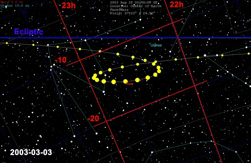

  • #34
Sylvain9595 said:
I've been comparing Mars retrograde motion data from JPL Horizons for the 2003 and 2012 oppositions and noticed something unexpected:
  • 2003 opposition: Earth-Mars distance = 0.373 AU (55.8 Mkm), retrograde arc ≈ 40 arcminutes in RA (over 61 days)
  • 2012 opposition: Earth-Mars distance = 0.674 AU (100.8 Mkm), retrograde arc ≈ 72 arcminutes in RA (over 81 days)
Minutes in right ascension (RA) are minutes of time, not minutes of arc. One hour in RA corresponds to 15 degrees, but only for motion along the celestial equator. Because the ecliptic is inclined with respect to the equator, the "hour" may be shorter than 15 degrees in constellations like Gemini or Sagittarius, and longer in Pisces or Virgo. Since the planets tend to move along the ecliptic, it is more resonable to consider the ecliptic longitude. I found your finding as puzzling as you did and checked some almanacs I still have on my bookshelf: the retrograde arc was about 19 degrees in 1997 (at a distance of 99 million kilometers) and about 13 degrees in 2020 (at 62 million kilometers). So we seem to have reached an agreement on the facts.
As to the why, @mfb in his post #5 has already given an explanation. The small speed difference of 2.8 km/s at a distance of only 55.8 million kilometers translates to an angular speed of about 0.25 degrees per day, whereas the difference of 8.3 km/s at 100.8 million kilometers produces 0.41 degrees per day. Combine that with the shorter duration of the nearer opposition (61 days versus 81 days) you see that the planet will not travel so far during its retrograde motion.

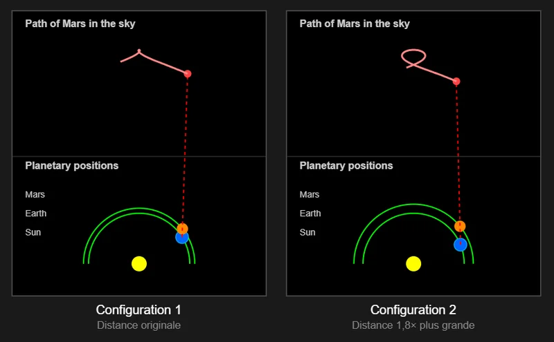

  • #35
I have to admit you're right!
I've created a better animation:
Configuration 1 (2003): Earth-Mars distance = 8, Earth's speed = 1.14 times the speed of Mars
Configuration 2 (2012): Earth-Mars distance = 14.4 (1.8 times greater), Earth's speed = 1.33 times the speed of Mars
Link to the animation: codepen.io/Boanerges-the-solid/pen/myEryvL
Thanks everyone for your replies, it was really very kind of you!
  • #36
That's a darned impressive animation @Sylvain9595! Did you write that yourself?
For those that don't follow the provided link, here is a snapshot:
Readers will notice that Configuration 1 has Mars and Earth in close proximity, yet it results in a very short arc of retrograde motion.
It's quite counter-intuitive to the passing-cars-on-a-highway analogy.

  • #37
DaveC426913 said:
That's a darned impressive animation.
You can thank the Claude AI for that, I just gave her the instructions ;)

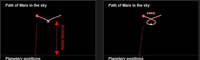

  • #45
Wait a second, we did solve the problem I outlined in my first message, but now I've run into an even bigger one!
Here's the actual observation provided by Dave:
It's clear that Mars is observed approaching us in the first part of the loop and then moving away from us in the second part, whereas my animation shows exactly the opposite! In other words, the loops in my animation are "upside-down" compared to the actual observation.
To match the observation, the yellow dot centered on the right-hand loop should be closer to Earth—not farther away (in this image, the trajectories have been reversed compared to the other animation)!
The loops should appear the other way around, just like on the ancient tychonic model :

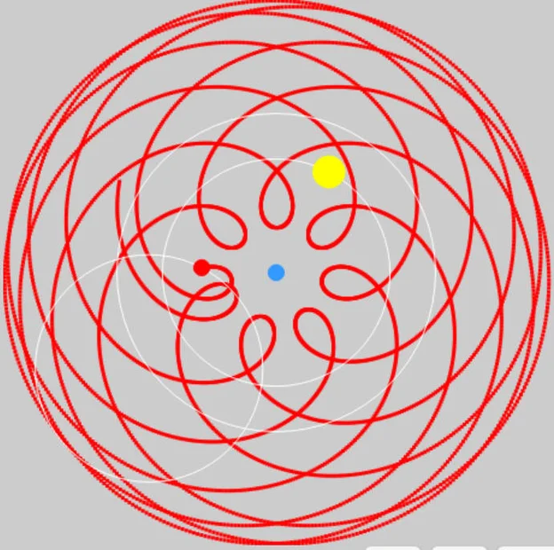

I should mention that I was inspired by this animation to create my own:
Witch I found here: https://people.highline.edu/iglozman/classes/astronotes/retrograde.htm?utm
  • #46
Are you sure my image isn't upside down? One of the oppositions was in the southern hemisphere. I had to rotate the image 180 degrees to align it. I was not concerned with "true" orientation; I was only interested in relative magnitude.
In retrospect, I think that's not what you're concerned about.
You are concerned your simulation doesn't represent radial distance properly (the Y-axis). I didn't expect it to. It's a projection, is it not? The Y-axis in your simulations doesn't have to represent anything at all.

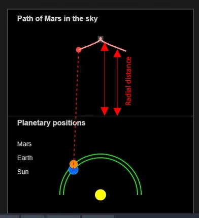

  • #49
Of course--the first part of the loop is before opposition, when the Earth-Mars distance is decreasing, and the second part of the loop is after opposition, when the Earth-Mars distance is increasing.
No, it doesn't. See below.
It is. At the point in your animation where the yellow dot is, Earth and Mars are at opposition, so they are at the point of closest approach.
  • #50
The loops are not representing the complete path of Mars in an Earth-centered frame. They are representing the apparent position of Mars on Earth's sky. [Edit--actually even that's not true--see my next post.] In other words, they are not representing Earth-Mars distance at all, only Mars's angular position on Earth's sky. To read off Earth-Mars distance, you need to look at the positions of the planets on the circles you drew at the times corresponding to various points on the loops.

  • #56
PeterDonis said:
There is no such thing in your animations. They don't even represent enough of what's going on in the "loops" for there to be any such effect. That was my point.
I think all he was expecting was this:
i.e. that, when at opposition, Mars should be at its closest (along the Y-axis), rather than farthest.
(I've simply mirrored the projections.)
I'm not concerned about it. The projection is not meant to illustrate anything except the actual retrograde phase, which it does quite nicely.
