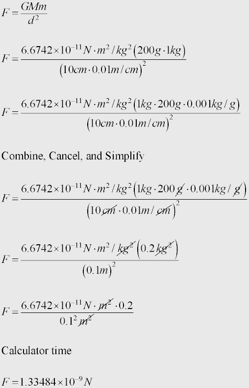

Two objects, one with a mass of 200g, and the other with a mass of 1 kg are placed 10 cm apart. What is the gravitational attraction between the objects?
Background: I'm performing an experiment in which a horizontal beam is suspended just above the ground with weights at either end. The larger weights are placed away from the smaller ones, so that the beam would have to turn for the distance between te large and small weights to decrease. I need to find the gravitational attraction between the objects, expressed in... well first I need to know which unit it would be expressed in.
I think it would be expressed in Newtons. Is this correct?

G is not a force, it is called the universal gravitational constant. It is the same everywhere. For your calculation, you must convert all your units into kg, m, s, so everything is consistent. For example in your equation you have (200g*1000g). You need to change the mass from grams to kilograms, to be consistent with the units you see in G. The same goes for distance, it must be in meters.

These units are not quite right. It should be (N*m^2/kg^2) or (m^3/s^2*kg) if you expand it out.
So F= 6.6742 x 10^-11*m^3*s^2*kg^2 (200g*1000g)/ 0.01 ? this needs to be squared
(200kg)/0.01 I don't understand what this is.

This is a good problem to get you used to unit manipulation. You did everything right, except as hage pointed out, you can't use grams because the number you are using for G only works with kilograms. I've cleaned up the math a bit so you can see step-by-step where different units combine and cancel
