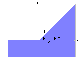

Re: Unsolved statistic questions from other sites, part II
chisigma said:
Posted on 08 17 2012 on www.mathhelpforum.com by the member pyromania and not yet solved…A post office has 2 clerks. Alice enters the post office while 2 other customers,Bob and Claire, are being served by the 2 clerks. She is next in line. Assume that the time a clerk spends serving a customer has the exponential (lambda) distribution. What is the expected total time that Alice needs to spend at the post office?...The answer gives that the expected waiting time(waiting in line) is ½ 1/lambda and the expected time being served in 1/lambda, so the total time is 3/2 1/lambda. I don't understand why the expected waiting time (waiting in line) is ½ 1/lambda…
Let suppose to have two exponential r.v. X and Y with...
$\displaystyle f_{x}(t)=f_{y}(t)= \begin{cases} \lambda\ e^{- \lambda\ t}&\text{if}\ t>0 \\ 0 &\text{if}\ t<0 \end{cases}$ (1)
... and we want to find the p.d.f. of the r.v. Z= min (X,Y). Observing the following diagram...
... we have...
$\displaystyle P\{ Z<z\} = 1- \lambda^{2} \int_{z}^{\infty} \int_{z}^{\infty} e^{- \lambda\ (x+y)}\ dx\ dy = 1- e^{-2\ \lambda\ z}$ (2)
... so that is...
$\displaystyle f_{z}(z)= \begin{cases} 2 \lambda\ e^{- 2 \lambda\ z}&\text{if}\ z>0 \\ 0 &\text{if}\ z<0 \end{cases}$ (3)
... and...
$\displaystyle E\{Z\}= \int_{0}^{\infty} z\ f_{z}(z)\ dz = \frac{1}{2\ \lambda}$ (4)
Kind regards
$\chi$ $\sigma$

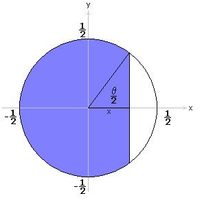

Although at first may seem 'easy', the solution requires several steps. The first step is, given two r.v. X and Y uniformly distributed from 0 to1, the p.d.f. of the r.v. Z=X-Y is...
$\displaystyle f_{Z} (t) =\begin{cases} 1+t\ \text{if}\ -1<t<0 \\ 1-t\ \text {if}\ 0<t<1 \\ 0\ \text{otherwise} \end{cases}$ (1)
... and the demonstration of that is left to the reader. The second step istofind the p.d.f. of the r.v. $U=Z^{2}$ and that is achieved considering that...
$\displaystyle P \{U<t\} = P \{Z<\sqrt t\}= 2\ \int_{0}^{\sqrt t} (1-t)\ dt= 2\ \sqrt t -t $ (2)
... and deriving (2) we have...
$\displaystyle f_{U}(t)= \begin{cases}\frac{1}{\sqrt t}-1\ \text {if}\ 0<t<1 \ \\ 0\ \text{otherwise} \end{cases}$(3)
More steps will be realized in successive posts...

The r.v. U having p.d.f. (3) is the square of the distance between two random points in the interval (0,1). Now we proceed as in...http://www.mathhelpboards.com/f23/unsolved-statistics-questions-other-sites-932/index8.html#post7039
... and...
http://www.mathhelpboards.com/f23/unsolved-statistics-questions-other-sites-932/index9.html#post7118
... and we find...
$\displaystyle \mu= E (\delta^{2})= \int_{0}^{1} (\sqrt t -t)\ dt = \frac{1}{6} \implies E (\delta)= \frac{1}{\sqrt{6}}$ (4)
Now we suppose to have two r.v. $U_{1}$ and $U_{2}$ each having p.d.f. (3). In this case if $U=U_{1}+U_{2}$ it will be... $\displaystyle E (\delta^{2})= 2\ \mu= \frac{1}{3} \implies E (\delta)= \frac{1}{\sqrt{3}}$ (5)
... and (5) is the solution of the proposed problem. Of course in n dimension is...$\displaystyle E (\delta^{2})= n\ \mu= \frac{n}{6} \implies E (\delta)= \sqrt{\frac{n}{6}}$ (6)

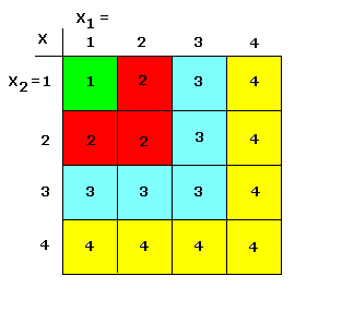

For illustrative purpose let's start with $Z_{1}$ in the particular case N=4 and n=2, so that is $Z_{1}= \text{max}\ (X_{1},X_{2})$, and some aids can come from the following table...
https://www.physicsforums.com/attachments/478._xfImport
Calling $p_{k,4,2}$ the probability that $\text{max}\ (X_{1}, X_{2})=k$ for the samples $X_{1},\ X_{2}$, it is easy to see from the table that, if $X_{1}$ and $X_{2}$ are independent and uniformely distributed from 1 to 4, is…
$\displaystyle p_{k,4,2} = P \{X_{1} \le k, X_{2} \le k \} - P \{X_{1} \le k-1, X_{2} \le k-1 \}= \frac{k^{2}-(k-1)^{2}}{16}$ (1)
The example now illustrated makes easier to find the general formula...

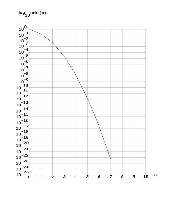

... with $p=.1$ and $n=10000$. The direct computation of (2) of course requires a computer tool like...
http://www.stat.tamu.edu/~west/applets/binomialdemo.html
... that gives $= .1467...$ . Alternatively we can approximate the (1) with $\displaystyle P_{n,k} \sim N (\mu, \sigma^{2})$ where...
$\displaystyle \mu= n\ p\ ,\ \sigma^{2}= n\ p\ (1-p)$ (3)
... so that the requested probability is...
$\displaystyle P \sim \frac{1}{2}\ \{1 + \text{erf} (\frac {968 - \mu}{\sigma\ \sqrt{2}})\}$ (4)
Also in this case You need a computer tool fot the computation of (4)... 'Monster Wolfram' gives $P \sim .143061$... Kind regards $\chi$ $\sigma$
