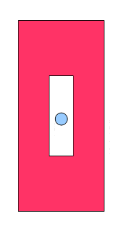

I am unfamiliar with the 'flexible joint' of which you speak. As you can see I have a roll pin jammed into the bushing's set hole which also corresponds to a hole in the shaft. I think this is what is taking a good portion of the load and transmitting it through the motor, which is NOT what I want. So what is a flexible joint in this regard? Would a roll pin that is much smaller than the set hole help accomplish this?
You want the pin to be a tight fit in the bushing, otherwise it may work loose and fall out. Make a rectangular slot in the shaft, so the pin is a loose fit and the shaft can move up and down relative to the pin. See the attachment for a side view of the shaft and pin.

Thanks! The drawing helped a lot. I'm going to do that right now. I'll let you know what happens.
OK, now I understand how a thrust bearing works! I knew the original design had a problem and you all were very helpful in making the point that it was too tightly bound to the motor's shaft. AlephZero's picture clarified for me how I could disengage the shaft from the weight load while still using its torque. Once I took it apart, machined the shaft and made the pin hole into a slot, I could see just how it would work when re-assembled. I did re-assemble and load it up and it went into testing at 12 midnight EST. The last motor was making noises of complaint less than 6 hours later, but appeared labored almost from the beginning. This time there is no sound at all and I am hopeful that when I awaken tomorrow it will still be soundless. I'll let you all know. Thanks again to one and all.

The suggestions worked. I have run the motor since last week around this time, and not had a problem, or even bad sounds. Thanks one and all.
