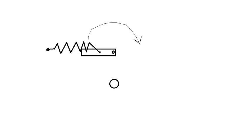

I am trying to design a certain mechanism. It is basically a rotating tube(a DC motor is driving it) attached to a motor at one end. There is a spring attached to just about the midpoint of the rectangular tube. The tube will spin and start stretching the spring. once it reaches the other side, the motor will cut out and the force of the spring will rotate the tube back to its original position. The whole point is for the tube to hit a ball on its way back. If I have a certain motor with these specs:

then how can I determine what the max load rate of the spring can be, as well as the amount of force the ball will be hit by? The rectangular tube is 10 inches by 1 inch by 1 inch and hollow on the inside. Thickness is about 1/16". It is made out of aluminum. I'm including a picture of what it looks like.. The spring will be mounted a little bit lower than the pivot point of the tube so that it will rotate the tube all the way around. I apologize for the crappy paint =) Any help you guys could offer would be greatly appreciated =)
-TwistX

Getting a lot of views but no responses... Initially I was going to treat this as a dynamics problem... But now I see it more as a statics problem since I'm focusing on stall torque. Overall, I do not want to damage the motor but I still want to place maximum force on the ball... I understand that the force of the spring can vary depending on the placement in reference to the pivot point and mounting point on the tube.

I'm not sure exactly what you're having trouble with.
Maximum load rate of the spring? You mean the rate of change of force on the spring while it's being loaded by the motor? I don't want to think too hard about that in case it's not what you're after.You can't determine the force on the ball from this. The force will vary during the contact time, and will depend on the elasticity and mass of the ball.
Do you want to maximize the speed of the ball? In that case you should maximize the impulse applied to it, not the force.
