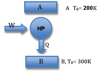

I have another problem now.
I've proceeded this way with the exercise. From then, I've made a scheme, similar to the exercise you helped me before (I think its pretty much like the same).
[tex]\ln \frac{T_{AF}}{T_{A0}}=\ln \frac{T_{BF}}{T_{0F}} \rightarrow T_{AF}=\frac{2T_{BF}}{3}[/tex]
[tex]W=Q_h-Q_c \rightarrow 400\ln(1.5)=\frac{3}{2}(T_{BF}-300)-\frac{3}{2}(T_{AF}-200)\rightarrow T_{BF}\approx 624K[/tex]
Now, I try to get Qc, but I think the result I get is wrong, I don't want you to make the numbers, just want you to tell me if what I did is wrong, or if its okey and the mistake is given by a simple error of calculus.
[tex]Q_c=W-Q_h \rightarrow Qc=-400R\ln(1.5)+R\frac{3}{2}(624-300)[/tex]
It gives [tex]Q_c \approx R 324[/tex]
I think it doesn't make much sense this result. But I'm not sure. The impression it gave me is that its bigger than the internal energy of the system A for it's initial state, which will be a big contradiction. U0=cRT=3/2 R 200K
Thank you so very very much for your predisposition for helping and your fast answer!
