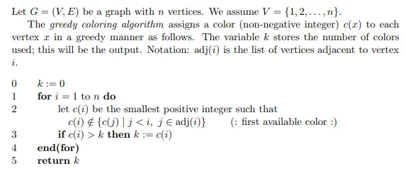

Let ##e_i(G)## denote the number of vertices of a graph ##G## whose degree is strictly greater than ##i##. Use the greedy algorithm to show that if ##e_i(G) \le i+1## for some ##i##, then ##\chi(G) \le i+1## (Discrete Mathematics by Biggs, 2nd Ed, Exercise 15.7.3)
Definition of "the greedy algorithm". One such definition (which matches what my book uses) can be found here: https://people.cs.uchicago.edu/~laci/HANDOUTS/greedycoloring.pdf (I also added a screenshot of the definition in my post)
Hi!
I am struggling with the exercise I mentioned under "Homework statement".
The exercise is about a specific "greedy vertex coloring algorithm". One definition (which matches what my book uses) can be found here: https://people.cs.uchicago.edu/~laci/HANDOUTS/greedycoloring.pdf
Here is also a screenshot of the relevant parts of the linked PDF, i.e. the def. of the algorithm:
Sadly I don't have much to show as far as a solution attempt goes, as I am stuck on how to proceed.
I thought that one approach might be to prove that this property of the greedy algorithm is true, given my constraints: ##|\left\{c(j)|j<i, j \in \text{adj}(i)\right\}| \le i##, because that implies that the no color ##> i+1## will be picked by the greedy algorithm.
However, I can't figure out a way to prove that.
The trick is to handle the vertices in the right order. Which vertices will be the most problematic? Deal with those first.
