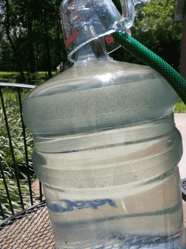

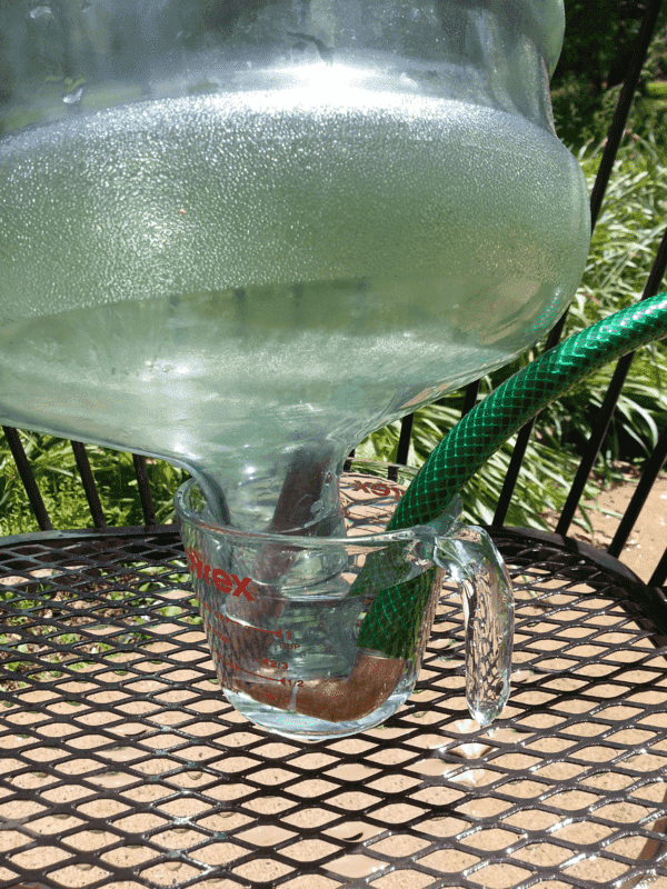

Find a rigid transparent container with a neck. Fill it with water and hold it inverted with the neck submerged. Blow your air into that with a short hose. The water level in the inverted container now indicates the volume expelled.
It can be done with a cup, say half liter. Just fill the thing multiple times until you run out of air. A cup might work better than a drink bottle due to the speed at which it can be refilled with water on each iteration.

I used to use a demijohn filled with water and inverted in a bowl of water. Then simply blow air in through a plastic tube. Two easy ways to measure the volume. Rough measurement can be marked on side as you fill with water. More accurately, measure the full volume, then measure the water left after expt.
As you say, 4.5 l is not enough for a fit adult male. I used two jars and switched the tube when one was nearly filled with air.

I like that method, very precise. The weight of the water will slightly lower the pressure of the water over estimating volume but high school physics gives the correction?

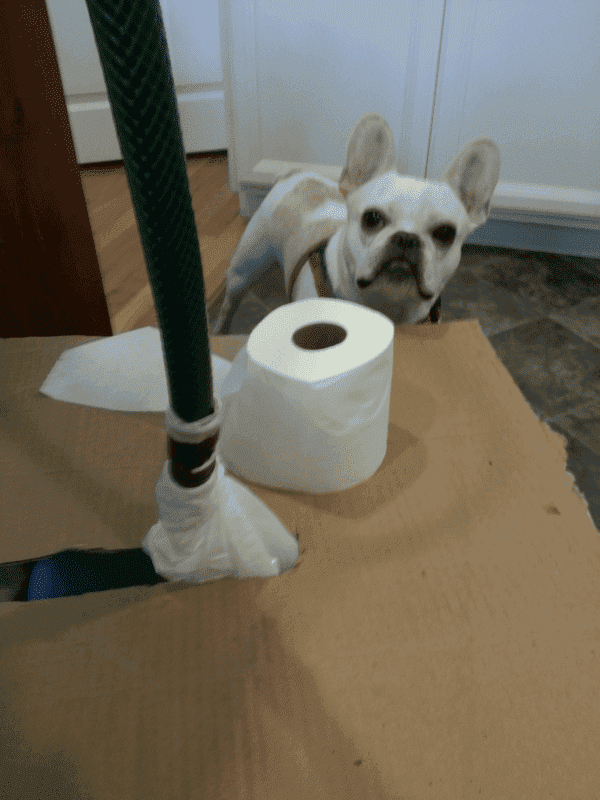

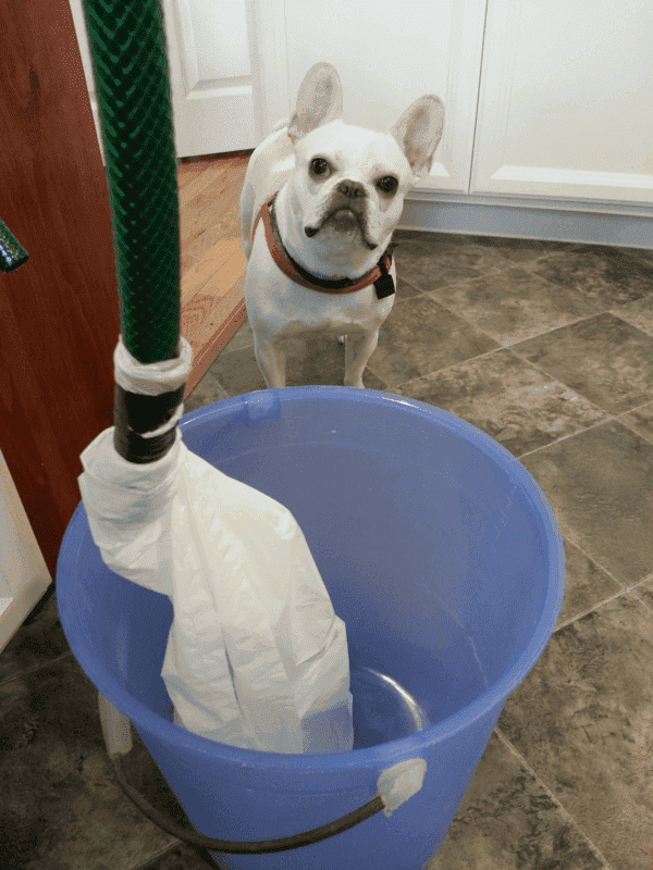

An improvement of my technique? Get 10 gallon trash can plastic bag liner and seal a short length of hose as in post 1. Then using a bucket of know volume see how many lungfuls of air it takes to inflate the plastic bag in the bucket, the last lungful will need to be estimated.

Pressure on the water in the container can be eliminated by having it level with the water surface when you note the air level at the end of the exhale. The air then will be at normal pressure and will fill the volume as marked on the container.

That is where the container of known volume comes in. You inflate the bag in the container and when the inflated bag fills the container you will approximate the volume, a "lid" helps.
Just did 4 lungfuls each over two experiments to displace 5 gallons (minus about a cup of water) and did not get faint.
16 liter bucket with 10 gallon trash bag and lid, dog for a sense of scale.
16 liter bucket with 10 gallon trash bag.
With some care, 2 3/4 lungfuls then 2 7/8 lungfuls to fill bag in 16 liter bucket.

Okay, or you could just lower (or raise) the bottle until the water levels line up, then cap it.

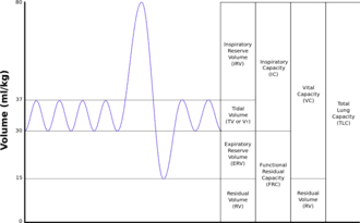

You are not measuring lung capacity. You are measuring the tidal volume.

https://en.wikipedia.org/wiki/Tidal_volume
"Tidal volume (symbol VT or TV) is the lung volume representing the normal volume of air displaced between[clarification needed] normal inhalation and exhalation when extra effort is not applied. "
From the wiki article image it looks like I was measuring "vital capacity".
