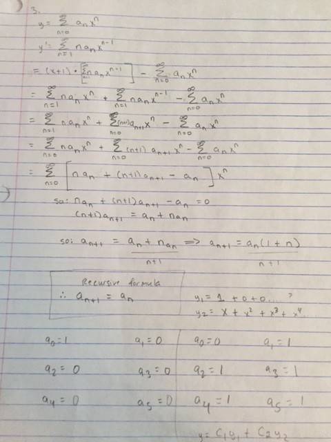

Use series methods to find the solution corresponding to $a_0 = 1$ for the equation: $(x+1)y' - y = 0$
I just need someone to verify if my solution is correct.
I ended up with the recursive formula being: $a_{n+1} = a_n$ and I ended up with $y_1 = 1 + 0 + 0 ...$ and $y_2 = x + x^2 + x^3 + x^4...$ and $y = C_1y_1 + C_2y_2$

Do you really have to use series for this? You can get an EXACT solution quite easily by separating the variables or using an integrating factor...

Yes, unfortunately, I have to use the series method as the question specifically states Use series methods to solve.. :(
- - - Updated - - -
Is my solution correct?
So for my final solution I have
recursive formula: $a_{n+1} = \frac{a_n(1-n)}{n+1}$
$y_1 = 1 + 0.. + 0 .. + ...$
so $y = C_1y_1$
UPDATE: SOLVED
The final solution is:
Recursion Formula: $a_{n+1} = \frac{a_n(1-n)}{n+1}$
$\therefore y_1 = 1 + x + 0 + 0 + ... + ...$
