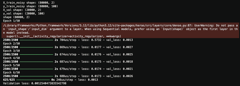

I coded a neural network model to predict solutions to ##u''(x)=100\sin(5x)## over ##[-1,1]## using Tensorflow. The boundary conditions at ##x=-1## and ##x=1## uniquely determine the solutions. I'm using a very basic model architecture with the relu activation function.
To train the model, I generated a set of deterministic solutions with random boundary conditions ##u(-1)=a## and ##u(1)=b##. I then added a small amount of noise to these solutions. However, the model's accuracy is significantly worse compared to the most basic finite difference methods. Is there anything that I did wrong in the code below? Thanks in advance for your input regarding the model, suggestions to make the project more interesting, etc. :bow: :smile:
Can someone with more experience provide guidance on improving this project? Additionally, does anyone have ideas to make this project more interesting?

Code:
# Add noise function
def add_noise(data, noise_level=0.1):
    noise = np.random.normal(-noise_level, noise_level, data.shape)
    return data + noise
# Generate base data
X, y = generate_data(100000)
# Split data into training and validation sets
X_train, X_val, y_train, y_val = train_test_split(X, y, test_size=0.2, random_state=42)
# Add noise to the training data
noise_level = 0.1
X_train_noisy = add_noise(X_train, noise_level)
y_train_noisy = add_noise(y_train, noise_level)
print("X_train_noisy shape:", X_train_noisy.shape)  # (800, 2)
print("y_train_noisy shape:", y_train_noisy.shape)  # (800, 100)
print("X_val shape:", X_val.shape)    # (200, 2)
print("y_val shape:", y_val.shape)    # (200, 100)
print("X_train_shape:", X_train.shape)  # (800, 2)
print("y_train shape:", y_train.shape)  # (800, 100)
print("y_val shape:", y_val.shape)    # (200, 100)'''
# Define the model
model = Sequential([
    Dense(64, activation='relu', input_shape=(2,)),  # Input layer with 2 neurons
    Dense(128, activation='relu'),                   # Hidden layer with 128 neurons
    Dense(256, activation='relu'),                   # Hidden layer with 256 neurons
    Dense(100)                                       # Output layer with 100 neurons
# Compile the model
model.compile(optimizer='adam', loss='mse')
# Set up early stopping
early_stopping = EarlyStopping(monitor='val_loss', patience=5, restore_best_weights=True)
# Train the model with noisy training data and clean validation data
history = model.fit(X_train_noisy, y_train_noisy, epochs=50, batch_size=32, validation_data=(X_val, y_val), callbacks = [early_stopping])
# Train the model with clean training data and clean validation data
history = model.fit(X_train, y_train, epochs=50, batch_size=32, validation_data=(X_val, y_val))'''
# Evaluate the model on the validation set
val_loss = model.evaluate(X_val, y_val)
print(f"Validation loss: {val_loss}")

The nn algorithm as it stands is not accurate. The global error gets as low as .03 which is still huge compared to the basic finite difference method. I want to know how to get the model as accurate as it can be, before I introduce any complexity to the algorithm.
Some things I've tried: Introducing more layers, using different activation functions, using dropout layers, L2 regularization, and increasing the number of epochs have not been successful. Increasing the size of the training data has been mildly successful but has diminishing returns.

I switched to Sigmoid activation function, deleted 2 hidden layers and lowered the number of nodes in the one remaining middle layer. I'm happy that the result is consistently around twice as accurate as before, despite being simpler.
I'll experiment some more, document my findings in detail, and move on.

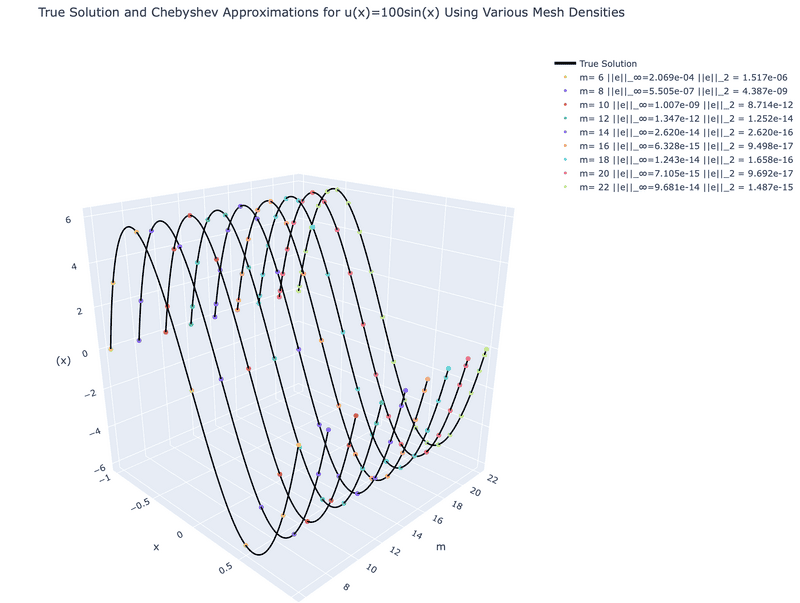

I've used MNIST data to train a convoluted neural network for classification tasks, as part of a class project. It seems that neural networks are much better suited for those tasks than solving equations that require much higher accuracies.
The Chebyshev spectral method I learned in Kyle Mandli's class can solve the same 1-D Poisson equation to around 1e-16, which is close to machine precision, in virtually no computation time.
This morning I found out it's possible to solve an ode to 5-4 using a neural network with just 11 nodes, using a self-supervising technique. I'm learning how to do something similar right now.
