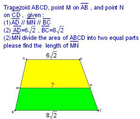

Here is my solution using integral calculus:
Without loss of generality, I choose to let the trapezoid to be mapped to the first quadrant region bounded by the coordinate axes, the line $x=1$ and the line $y=-2\sqrt{2}x+8\sqrt{2}$.
Next, choose a value $x=c$ such that:
$$\int_0^c-2\sqrt{2}x+8\sqrt{2}\,dx=\int_c^1-2\sqrt{2}x+8\sqrt{2}\,dx$$
Applying the FTOC, we find:
$$-\sqrt{2}c^2+8\sqrt{2}c=-\sqrt{2}+8\sqrt{2}-\left(-\sqrt{2}c^2+8\sqrt{2}c \right)$$
After simplifying, we have:
$$2c^2-16c+7=0$$
Taking the root such that $$0\le c\le1$$ we obtain:
$$c=4-\frac{5}{\sqrt{2}}$$
Hence:
$$\overline{MN}=y\left(4-\frac{5}{\sqrt{2}} \right)=-2\sqrt{2}\left(4-\frac{5}{\sqrt{2}} \right)+8\sqrt{2}=10$$
