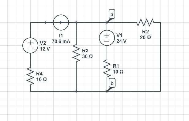

Find the potential difference between points a and b.
Picture of Circuit involved.
V=IR
ΔV=Vb-Va
Pretty much completely lost, due to the only one current shown I'm not sure which way the current flows through the rest of the circuit so I do not know how to go about the loop rule.
It started off kinda like
-I1(30Ω)=2.118 V
But I know that cannot be correct cause if you left from the 24V battery and went down you'd have something about 23.3V across there, like I said, completely lost, any help would be great.
This is useful, in a case like mine you wouldn't want multiple I notations of current cause then your introducing variables you don't know right?
should I go opposite the current from b→a?
like
ΔV=-(0.0706A)(10Ω)+12V=12.706V
Since that is the only value of I given?
Using the one know current, the current would be the same at a correct?
If so you couls just do
Va-Vb=-24V+(I)(10)
=>-24+(0.0706)(10)=-23.294
Which implies
Vb-Va=+23.294V
Or is this still the wrong path?
Do I need to use loop rules and find the unknown values of the current when it splits?
