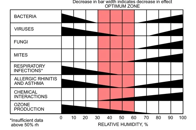

Averagesupernova said:
I have allergies to dust mites. You cannot keep a house clean enough to eliminate them. The solution is to keep the humidity low enough because they are unable to survive in low humidity. I'm told the only way they get moisture to survive is from the air. Get the humidity down to 35% and they can't survive. You do 'you' and I'll do 'me'.
This is what research tells ASHRAE about RH levels vs IAQ challenges, but sure, we make our own choices:
