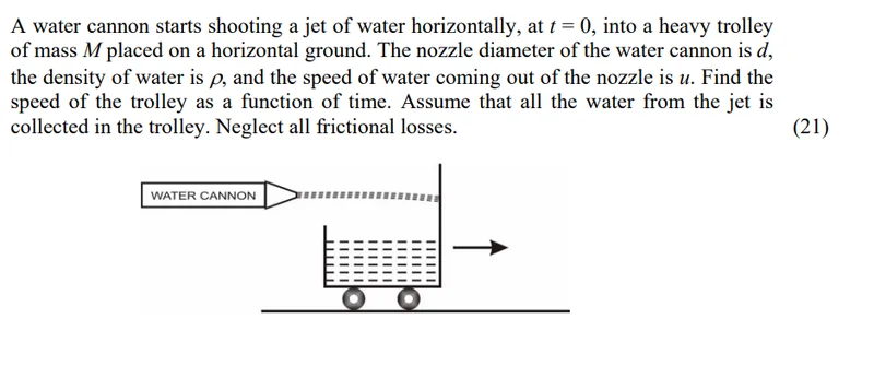

A water cannon starts shooting a jet of water horizontally, at t = 0, into a heavy trolley
of mass M placed on a horizontal ground. The nozzle diameter of the water cannon is d,
the density of water is ρ, and the speed of water coming out of the nozzle is u. Find the
speed of the trolley as a function of time. Assume that all the water from the jet is
collected in the trolley. Neglect all frictional losses.

Starting with the mass considerations #m(t)# is mass of water #M_{c}# mass of container and #M(t)# mass of total system
$$M(t) = M_{C} + m(t)$$
$$\Rightarrow \frac{dM(t)}{dt} = \frac{dm(t)}{dt}$$
$$P_i = Mv + u \, dm$$
$$P_f = (M + dm)(v + dv)$$
$$\Delta P = M \, dv + (v - u) \, dm$$
$$F = \frac{dP}{dt} = M \frac{dv}{dt} + (v - u) \frac{dm}{dt}$$
$$F = u \frac{dm}{dt} = \rho A u^2$$
from conservation of momentum , the cannon recoils with the same force which it applies.
$$\quad \frac{dm}{dt} = \rho A u$$
$$\therefore M \frac{dv}{dt} + (v - u) \frac{dm}{dt} = \rho A u^2$$
$$M \frac{dv}{dt} + (v - u) \rho A u = \rho A u^2$$
$$\frac{dv}{dt} = \frac{\rho A u [2u - v]}{M}$$
$$\int \frac{dv}{[2u - v]} = \int \frac{\rho A u}{M} \, dt$$
$$-\ln (2u - v) = \frac{\rho A u}{M} t + c$$ \\
given that at $t = 0, v = 0$
$$\therefore C = -\ln (2u)$$
$$ \frac{dM}{dt} = \rho A u \Rightarrow M(t) = M_C + \rho A u t$$
$$\ln (2u) - \ln (2u - v) = \frac{\rho A u t}{M}$$
$$\ln \left( \frac{2u}{2u - v} \right) = \frac{M - M_C}{M}$$
$$\exp \left[ \ln \left( \frac{2u}{2u - v} \right) \right] = \exp \left[ \frac{M - M_C}{M} \right]$$
$$\frac{2u}{2u - v} = \exp \left[ \frac{M - M_C}{M} \right]$$
$$2u \exp \left[ \frac{M_C - M}{M} \right] = 2u - v$$
$$v = 2u \left[ 1 - \exp \left( \frac{M_C - M}{M} \right) \right]$$
this doesnt match with the answer, am i doing anything wrong ? please help

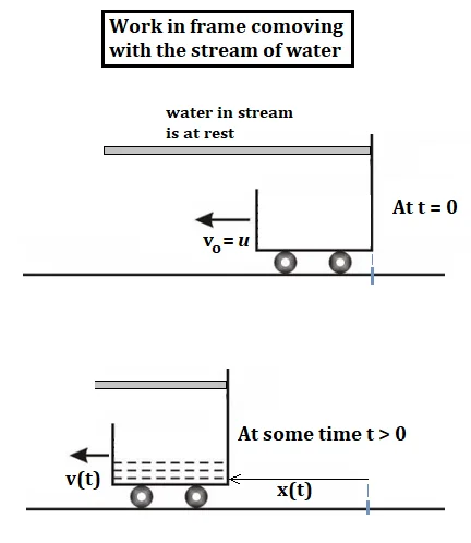

Here's another way to look at it. There are no external forces on the large mass M. A small mass, m, is fired at a known speed (the external force on m is already accounted for in its specified momentum). The mass m collides inelastically with the mass M. There are no external forces in the collision.
My approach was:
When the cart has moved s from the cannon, how much water has the cannon ejected? How much of that has reached the cart? What momentum did it supply?
In terms of ds/dt, how much momentum does the cart and contents have now?
From that I got ##\dot s=\frac{\lambda(ut-s)u}{1+\lambda(ut-s)}##, where ##\lambda=A\rho/M##.
I wound up with ##v=u(1-(1+2\lambda ut)^{-\frac 12})##.

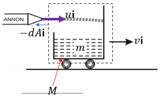

I'm trying to work this out from a Fluid Mechanics perspective with the Momentum Equation and Mass Conservation:
$$ \sum \boldsymbol{F} = \frac{ d}{dt} \int_{cv} \rho \boldsymbol{v} d V\llap{-} + \int_{cs} \boldsymbol{v}\rho ( \boldsymbol {V}\cdot d \boldsymbol{A} ) \tag{Momentum}$$
## \boldsymbol {v} = v \text{i} ## ( the velocity of the cart and its liquid contents rel. to fixed inertial frame )
## \boldsymbol {u} = u \text{i}## the jet velocity ( rel. fixed inertial frame )
## \boldsymbol {V} = ( u-v )\text{i} ##
## \sum \boldsymbol F = 0 ##
With uniform flow properties I'm getting an equation that appears somewhat ugly:
$$ 0 = \frac{d}{dt} \left[ (M + m ) v \right] + \rho A u( u-v ) $$
$$ 0 = \frac{d}{dt} \left[ (M + \rho A ( u-v)) v \right] + \rho A u( u-v ) $$
The term on the left is the rate of momentum accumulating in the control volume ( body plus liquid mass).
is this result in alignment with the rest of the group?
haruspex said:
I get the same result. A nice approach is to use momentum conservation in an inertial frame moving with the stream of water.
After finding v(t) in this frame, it's easy to transform back to the earth frame.
