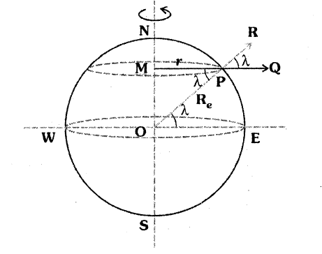

The discussion focuses on how latitude affects gravity and centripetal force due to Earth's rotation. Participants clarify that the centripetal force required for circular motion is not equal to the component of gravitational force, mgcos(λ), but rather that this component is larger than necessary. The normal force at the equator is reduced to about 99.7% of mg, resulting in a slight decrease in weight. Additionally, the apparent gravitational force can be calculated by combining gravitational force with the centrifugal force. The conversation emphasizes the importance of understanding the forces acting on objects in circular motion on Earth.
