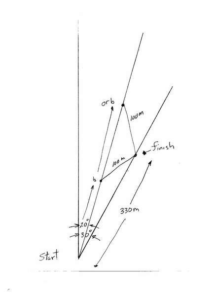

Amy wants to reach a destination that is 330m [E31 degrees N] from where she is. She travels a distance b towards [E20 degrees N] and then 100m to her destination. What is the distance b? (list all possible answers)

Have a picture of what is going on and the solution might follow?

Thank you for the picture, but every time I look at it (or my own diagrams), I still can only think of using trig to solve it. I just can't see how you can use components for this. :/
