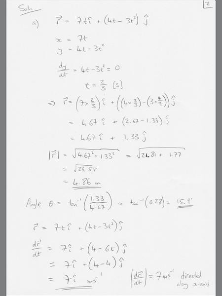

I was given an example in a lecture of a vector question which is typical of this module.
Question
The position of mass m is described as a vector r, from an origin such that r= 7t i + (4t-3t^2) j metres.
Find the magnitude and directions of r and dr/dt when dy/dt=0Now I have worked through this and know what to do but when I looked at the model answer I noticed what to me looks like a mistake?
I've attached the solution done by my lecturer but he deduces when 4t-3t^2 = 0
That t=2/3 which it can't be it has to be 4/3?I'm not sure if I am mistaken that's why I'm asking and if I am wrong I would like to know why:) thanks guys:)

I don't know whether these notes are in your own handwriting or in your lecturer's handwriting, but whoever wrote them got the equation for dy/dt wrong. The equation for dy/dt is
dy/dt =4-6t
This component of velocity is zero when t = 2/3.
It was the lecturers handwriting
So then the second part where he solves for the magnitude of r must be wrong as the t is added back in?

No, that part is okay. Everything looks okay to me in the attachment except for one thing.
The attachment has in it:
[tex]\vec r = 7 t \ \hat \imath + (4t - 3t^2) \ \hat \jmath[/tex]
[tex]x = 7 t[/tex]
[tex]y = 4t - 3 t^2[/tex]
[tex]\frac{dy}{dt} = 4 t - 3 t^2 = 0[/tex]
That last line has the problem. I think your instructor meant to write:
[tex]\frac{dy}{dt} = \frac{d}{d t} \{ 4 t - 3 t^2 \} = 0[/tex]
but neglected to write in the d/dt operator.
Everything looks okay after that though.
If you take the derivative of y with respect to t and set it equal to zero, you'll find that t = 2/3, which is shown on the attachment correctly.
Yeah, as collinsmark said, it might just be a prob of not writing d/dx as a step,
The ans is still supposed to be 2/3 seconds.
